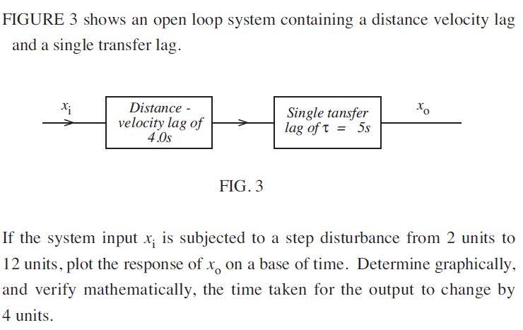

FIGURE 3 shows an open loop system containing a distance velocity lag
and a single transfer lag.
Figure 3 shows -
Xi Xo
---->----[Distance - velocity lag of 4.0s]---->----[single transfer lag if t=5s]---->----
If the system input Xi is subjected to a step disturbance from 2 units to 12 units, plot the response of Xo on a base of time. Determine graphically, and verify mathematically, the time taken for the output to change by 4 units.I know the guidelines but I am at a lost for where to even start with this. I don't know what it means by 'units' and this is not discussed anywhere in the learning materials I have been given. The learning materials also only briefly cover single transfer lags and I can't find any information about 'single' transfer lags on google. Only first-order lag, linear lag and exponential lags. Could it be that it has been worded differently and actually means something else?
If anyone could just give me guidance on how to even start this or any information that might be helpful is appreciated, Thanks!

I’m after a little guidance regarding this question: Am I right in thinking that the output will not change with regards to distance velocity lag of 4 seconds, it’s merely delayed?However, once the transfer lag starts (time constant 5 seconds) the output will start moving (exponential curve) towards 12 units of output.So…. the step disturbance is 12-2=10 units.Time constant is 5 secondsSo I just want 4 units (40%) of 5 seconds and to add this onto the 4 seconds of dist/velocity lag?4+2= 6 seconds for the output to change by 4 units??
"distance-velocity lag" and " single transfer lag" are terminology that I am not familiar with. Also, Figure 4 is not shown, so I don't know if there is some hint in the symbols used in the figure. I don't want to guess.
I think I am doing the same module. Figure 3 is attached. I have a bit of an idea where I am going with this, just trying to understand it at the moment

If you look at lesson CSA-1-4 on page 10 there is a bit about step and ramp changes. On that page there is an equation
output change=input change*(1-e to the power of -t/T) ( I don't know how to write that equation in latex form)
Output change is 4 units
input change is 10 units because the disturbance started at 2 and stopped at 12 so 12-2 = 10 units

Thanks, I have been looking at this equation and trying to get it to work but seem to be miles off.
Output Change = Input Change (1-e^-t/T)
4 = 10 (1-e^-t/5)
Re-arranged: t = -T ln (Output Change / Input Change)
t = -5 ln(4/10)
t = 2.55
I must be going wrong somewhere...
T (time constant) = 5 as per the assignment question?
Thanks
Not wrong
t is the elapsed time which is 2.55 seconds for one unit change.
The question is asking for the time taken for the output to change by 4 units so 2.55*4=...
You then have to create a graph.
I created a graph with an x-axis of 5 units and a y-axis of 12 units. I plotted a line from (y=2, x=0) to (y=2, x=2). We are told the step change occurred from 2 units to 12 units so from 0 units to 2 units nothing happened, it flat lined so to speak. It then jumped by 10 units so i plotted a line from (y=2, x=2) to (y=12, x=4).
There is a right angle triangle created here and the answer your trying to verify is the length of the hypotenuse. If you plot the graph then use square root (adjacent^2 + opposite^2) it gives you a very close answer to the one you proved using the math.

I understand it now!
2.55 is just 1 unit change so 4 unit changes would be 10.2
drawing the step change in graph form and getting the triangle works out to 10.19

Hello everyone.
I am new to Physics Forums. I seem to be doing the same course studying as you all too. I am having difficulty on how you managed to get
t = -5 ln(4/10)
t = 2.55
I am coming out with
t = 4.58
Any help would be greatly appreciated.

Sorry to resurrect this post.. @JE93 @David J
I also got 2.554 by rearranging 4=10*(1-e^-(t/5))
However I don't see how this is can 10.2s as the time constant (which is time to reach 63.2% which is greater than a 4 unit change) is 5s?
I was going to assume that 2.554 added to the delay of 4 seconds would give an overall of 6.554 seconds to change 4 units?
Sorry I am just confused how this can be correct, also the graph should be an exponential curve so drawing a right-angle triangle should also not work?

I think I have the formula correct, but it was the number that has been used that has confused me.
If you use:
t = -5 ln(4/10)
you get:
t = 4.58
to get 2.55 its actually:
t = -5 ln(6/10)
Which makes sense when putting into a graph.
Unless I missed something?
