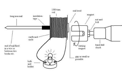

So you are clearly in the lab experiment range of power. I suggest with something easy to build, and then you can measure the volts and amps that it could make. Below is a very simple one using a cordless drill.
That and other lab scale experiments are described on this page.
http://www.creative-science.org.uk/gen1.html
Edit: The reason for the suggestion is the advanced calculations to see how much power you get can be more difficult than just building something.
Stay small, low voltages, be safe.
