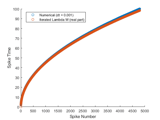

Cool, nice work! See attached code and plot :). I took the first brach of the W function and plotted the real part.
Code:
clear all
%% solve by simulation
t(1) = 0;
V(1) = 0;
dt = 0.001;
Nt = 100000;
for i=1:Nt
    V(i+1) = V(i) + (-V(i) + (i*dt))*dt;
    if V(i+1) >= 1
        V(i+1) = 0;
        t = [t,i*dt];
    end
end
%% solve by Lambert W
clear tl
tl(1) = 0;
for i=1:(length(t)-1)
tl(i+1) = 2+lambertw(0,-(tl(i) * exp(tl(i)) - exp(tl(i)))/exp(1)^2);
end
%% Plot
hold on
scatter(1:length(t), t)
scatter(1:length(real(tl)), real(tl))
legend('Numerical (dt = 0.001)', 'Iterated Lambda W (real part)')
xlabel('Spike Number')
ylabel('Spike Time')
[\CODE]

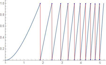

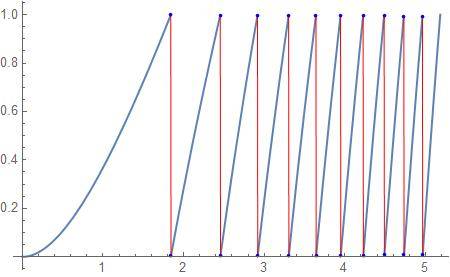

Here's my check of your formula in Mathematica. I had to remove the negative sign in the W-function in order for the predicted spike values to agree with the DE. Not sure why:
Mathematica:
myF[t_] := 2 + ProductLog[(t Exp[t] - Exp[t])/E^2];
tPrev = 0;
tNext = myF[0];
theSpikeData = Table[
   tNext = myF[tPrev] // N;
   mySol =
    First@NDSolve[{v'[t] + v[t] == t, v[tPrev] == 0},
      v, {t, tPrev, tNext}];
   solTrace[t_] = Evaluate[Flatten[v[t] /. mySol]];
   thePlot = Plot[solTrace[t], {t, tPrev, tNext}];
   result = {solTrace[t], tPrev <= t < tNext};
   tPrev = tNext // N;
   result, {i, 0, 10}];
endT = (Last@theSpikeData)[[2, 5]];
theSpikeTrain[t_] = Piecewise@theSpikeData;
Plot[theSpikeTrain[t], {t, 0, endT}, ExclusionsStyle -> {Red, Blue}]

You're right, I made a sign error - it should be ##\Psi(t) = (\Phi(t) - e^t)^{-1}\circ \Phi(t)##. Nice plot. You can see in my plot that the the discrepancy between the two solutiuons accumulates over time (in your code you start the DE from the analytical solution after each spike, in mine I do a spike-reset when the DE voltage exceeds 1). Presumably the Lambert W solution is more accurate, but in Matlab it actually seems to take longer to run than the numerical solution of the DE! (I suppose the time the DE takes depends on the chosen step size, so it could be faster or slower depending on chosen accuracy).
