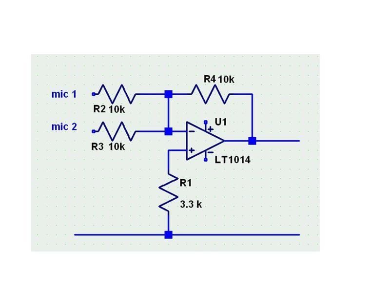

I've made a single opamp amplifier for a mic but it has this problem, when I play a very low
200hz tune the output of the opamp shows 6 mV and another 200hz tune at higher volume shows a 600 mV output, the problem is that if the loud tune is ON the low level tune doesn't make any difference on the output. Shouldn't the output go from 600 mV to 606 mV ?
And each tune is played by a separate speaker.
Are you summing the two input signals through a summing junction (the negative (inverting) input of an operational amplifier? This should sum the two amplitudes. See thumbnail.

I have the two sounds coming from two separate speakers but I have just one mic receiving both and the mic is connected like this: + and - of OPAMP to ground thru 1K, 100K - to OUT,
dynamic mic to ground and + of OPAMP

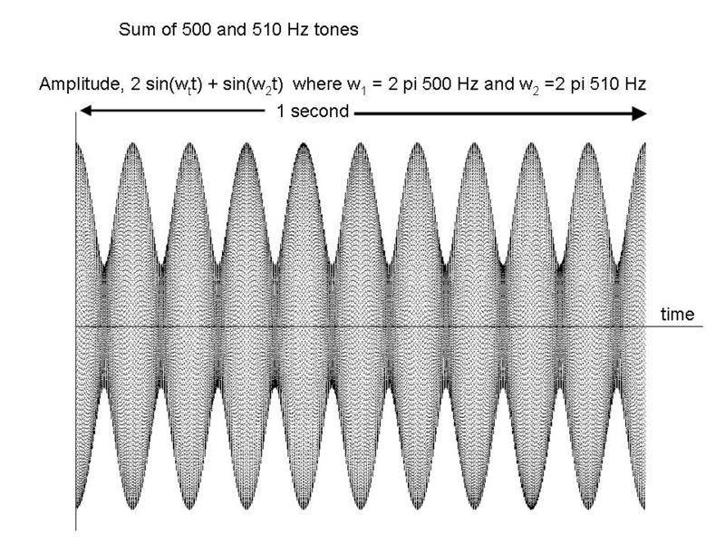

Only if the combination mechanism is non-linear. The microphone picking up multiple audio tones is a linear mechanism.
I seem to get a 10-Hz beat frequency in the amplitude between a 500 Hz and a 510 Hz tone (2:1 ratio).

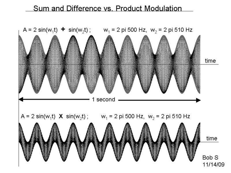

Hi Bob this has been discussed several times here recently so I'll only be brief. Technically you only get sidebands when you multiply two tones, not when you add them. Yes I know that the combination looks like there is a 10Hz component there but consider this, if you applied that waveform to a linear system with a resonance at 10Hz then I can tell for certain that it wouldn't resonate it.
Note to M718. Look carefully at Bobs wave form. He adds a "2" and a "1" but he doesn't get a "3". The RMS of two individual signals is 2/sqrt(2) and 1/sqrt(2), note however that the rms value of the resulting waveform is NOT the sum (which would be 3/sqrt(2)), the true RMS value of that waveform is actually sqrt((2/sqrt(2))^2 + (1/sqrt(2))^2) = sqrt(2.5).
To clarify the thumbnail in my post #15, here in this thumbnail are both a sum-and-difference (+), and a product (x) modulation of a 500-Hz signal with a 510-Hz signal. The amplitudes of the two signals in both plots are the same.
