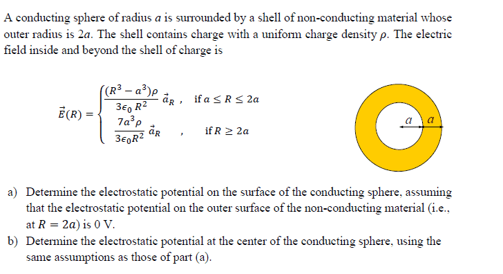

See picture
V = ## -\int E dl ##
a) I think you find V by just integrating E in regards to R. Then we integrate from the point of interest, which is a, to the 0 potential which is (R = 2a)?
b) If the same logic as a) applies here as well then we should integrate from the point of interest to the 0 potential. This should be from 0 to 2a.
Yes, except that R is a given constant, so better to say wrt some new variable, r say.
Yes, except that there is an easier way. Hint: it's a conductor.

For b, what do you know about the potential within a conductor?

The electric field inside a conductor (in this case 0 to a) is 0. So V should be a constant. Not sure if we need to go further than this?
I am unsure because of the wording in the task : "using the same assumptions as those of part (a)."
The assumption being "the electrostatic potential on the outer surface of the non-conducting material is 0 V." The stated assumption shouldn't affect the problem?

Yes, ##V## is constant throughout the conductor. You need to express V at the center of the conductor in terms of ##\varepsilon_0, a## and ##\rho##.
The choice of where ##V = 0## does affect the answer to part (b). For part (b) you want to still take ##V=0## at the outer surface of the non-conductor.

Yes. What do you get for an answer?
As @haruspex stated, you could do this but there is an easier way. As you stated in post #5, you know that V is constant throughout the conductor. So, how does the potential at the center of the conductor compare to the potential at the surface of the conductor?
a) we are integrating from a to 2a.
## V = -\int E dl = -\int \frac{R^3 \rho}{3\epsilon_0 R^2} + \int \frac{a^3 \rho}{3\epsilon_0 R^2} = - \frac {\rho}{3 \epsilon_0} \int R dR + \frac{a^3 \rho}{3 \epsilon_0} \int \frac{1}{R^2} dR = -\frac{\rho a^2}{2\epsilon_0} + \frac{a^2 \rho}{6\epsilon_o} ##
b) Let's assume we integrate from 0 to 2a. Shouldnt the answer be the same as a) if the electric field is 0 inside the conductor? This already seems easy enough to me.
But to answer your question, I think it should be the same?

For part (a) what limits of integration did you use?
Part (b) is really that easy. :smile:
for a) integration limits were a to 2a.
Getting the signs correct can be tricky. Recall that the basic relation is
##V(B) - V(A) = -\int_A^B \mathbf E \cdot d\mathbf l##
If you integrate from ##a## to ##2a##, what does the left-hand side of the above relation become? In particular, which of ##V(A)## and ##V(B)## would be zero and which would be the potential at the point that you are interested in?
