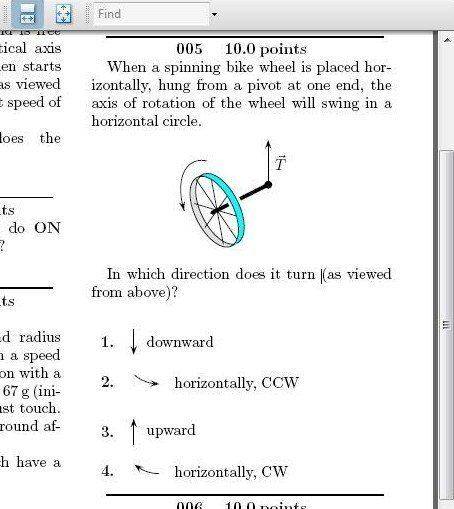

1. Homework Statement
{Number 5 on attachment. It has picture.}
When a spinning bike wheel is placed hor-
izontally, hung from a pivot at one end, the
axis of rotation of the wheel will swing in a
horizontal circle.
In which direction does it turn (as viewed
from above)?
1. downward
2. horizontally, CCW
3. upward
4. horizontally, CW
2. Homework Equations
Any? I'm unsure.
3. The Attempt at a Solution
I was thinking that it was downward, but I'm not sure how to prove my answer. (We're supposed to show work.) Any help?

This is when you use the right hand rule, correct? Because it's T= r X F?
But the image shows T pointing up. So do I just use that?
hi bmoore509! :smile:
I don't know what that T is, perhaps it's something to do with tension in the supporting cable. :confused:
but it isn't the torque … torque is always illustrated with a little round arrow, not a straight one
(and we usually write τ for torque, not T :wink:)
Yup! :smile:
… so which direction is the torque ?
I'm not 100% sure which direction r is. But wouldn't it be the direction of the arrow?
So Torque would point out towards us, right?
(Sorry, physics is not my best subject)

your angular momentum L has two components
one is the "orbital" angular momentum, which is constant, so you can ignore that
the other is the "internal" angular momentum Lw of the wheel on its own axle, which is constant in magnitude, but is along the direction of r
that is changing: draw Lw at two different times (close together), to see the direction of dLw/dt …
you need that to be the same direction as τ :wink:
But how do I figure out how to draw Lw?
