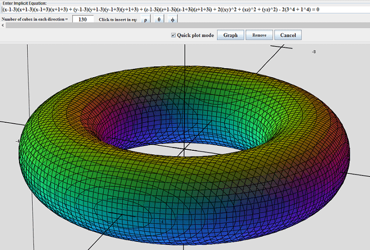

I came across this strange relationship when deriving the degree-4 equation for a torus. First thing that comes to mind is the 'Freshman's Dream'. Apparently, it was pure coincidence that they are equal. But, I don't believe in coincidences when it comes to a math expression. There is something about this one.
I found it when thinking about the 1D intercepts of a torus, along x,y, and z. Defined implicitly,
(sqrt(x^2 + y^2) - a)^2 +z^2 -b^2 = 0
The major diameter 'a' lays flat in the xy plane. This means the X and Y axes intercept as four points along a line, and have the four solutions x = ± a ± b , and y = ± a ± b . These two can be seen the implicit function, by canceling out two dimensions, and observing the result:
(sqrt(x^2) - a)^2 -b^2 = 0

The final result, which graphs a perfect torus using complex conjugates for the Z-intercept:
(x ± b ± a)^4 + (y ± b ± a)^4 + (z ± b ± ai)^4 + 2((xy)^2 + (xz)^2 + (yz)^2) - 2(a^4 + b^4) = 0
expands into
(x-b-a)(x+b-a)(x-b+a)(x+b+a) + (y-b-a)(y+b-a)(y-b+a)(y+b+a) + (z-b-ai)(z+b-ai)(z-b+ai)(z+b+ai) + 2((xy)^2 + (xz)^2 + (yz)^2) - 2(a^4 + b^4) = 0
setting a = 3 , b = 1
(x-1-3)(x+1-3)(x-1+3)(x+1+3) + (y-1-3)(y+1-3)(y-1+3)(y+1+3) + (z-1-3i)(z+1-3i)(z-1+3i)(z+1+3i) + 2((xy)^2 + (xz)^2 + (yz)^2) - 2(3^4 + 1^4) = 0which will graph into a perfect torus:

The second line does not follow from the first one, it is also wrong in terms of the geometrical interpretation (where x,y,z are real).

Philip said:
which is also equal to the four solutions, as graphed in above pic,
z = - b - ai , b - ai , - b + ai , b + ai
It is not, and repeating this completely unjustified claim won't make it right.
Well, that's the thing. When I put those proposed four solutions for z in the torus equation, as graphed in above image, it came out correct. The imaginary numbers define the hole, and the empty space. I understand how it seems wrong. I'm not sure how to properly prove any of it to you. Other than to show you what this function makes when graphed, using the complex numbers in this particular way. If it is wrong, then it seems like the end result would also show this conclusion, as well. That is what's confusing me right now.
Consider b=1,a=1 for example
z = ± sqrt(b^2 - (-a)^2)=0 has the only solution z=0.
None of those four options is a solution: z = - 1 - i , 1 - i , - 1 + i , 1 + i
How do you even "put complex z into a graph"? Putting them into the original equation (sqrt(x^2 + y^2) - a)^2 +z^2 -b^2 = 0 does not give a correct result.
It's the other equation I wrote that used complex numbers, not the standard implicit form of
I used the function
which is equal (discovered by expanding the equation and/or plotting the function) to
(sqrt(x^2 + y^2) - 3)^2 +z^2 -1^2 = 0
You can copy-paste these two into calcplot3D, to see what I mean: http://web.monroecc.edu/calcNSF/
I tried to manually build a degree-4 torus equation out of using 1D intercepts along x, y, and z. axes. The problem was how to define an axis that makes no intercepts, that threads right through the hole. Axes X and Y have four real solutions, but Z is different. Intuition lead me to using complex numbers to define the empty void, with potential real intercepts spaced in a higher dimension of the real plane ( from the z-perspective). Potential real intercepts is the key phrase, since the hole is not infinite. Moving the torus far enough will make the Z-axis intercept some part of the ring, making a maximum of two real solutions, plus two complex. That strange torus equation ended up making the exact, identical shape, with a=3 and b=1.
It's very weird, I know. You're not the only one who tells me Z won't make complex numbers for a solution. It was a hypothesis and experiment that lead me to this strange relation. There doesn't seem to be a direct way to get the complex numbers, through any known algebraic means. That's what made me so curious about it!
