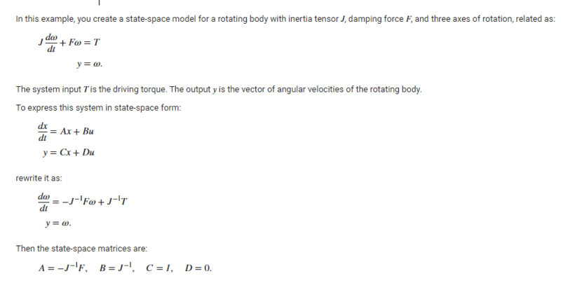

I have viewed the pdf multiple times and have even gone through the example on there before attempting it on my assignment, but you haven't confirmed whether I answered your question right on the state variables. Nor commented on the method i was using from the same PDF you sent to let me know if I was on the right track, so what help is it to keep defining a state space system all over again and to simply refer back to the pdf? The pdf isn't interactive and won't help me if I get stuck, that's why i came here
I wanted to consult you on the source that I took from Mathworks because i felt it could make the method simpler for me, i appreciate your attempt in answering that
I decided to give that method a shot before the deadline and it seems like it's working as both SS models appear to be stable on Matlab, which is a good sign. Thank you for the help you provided so far, although I wish more people had participated to give more advice, best regards
I don't know what to say about that example. It looks good to me. It does not look like a different method though, just a different example.
