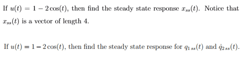

I am trying to understand what the difference in the two questions (linked) are. I understand how to find the steady state response for x. Is the second question just asking for the first and fourth element in the Xss matrix?
Xss=[q1 q2 q1dot q2dot]

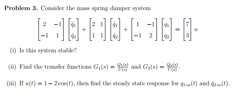

I think you will have to give more information of what these questions are talking about. I certainly have no idea. What is the context?
This is for a mass spring damper system. Here's an image of the full problem
