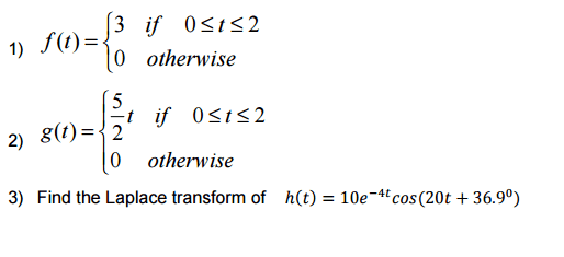

Step function Laplace transform - can someone check my work?
In summary, the conversation discusses three problems involving Laplace transforms, with the first two problems providing equations and solutions, while the third problem remains unsolved. The conversation suggests using the integral definition of the Laplace transform and Euler's rule to solve the third problem.
eehelp150
237
##3u(t)-3u(t-2)##
##\frac{3}{s}-\frac{e^{-2s}3}{s}##
##\frac{5t}{2}u(t)-\frac{5t}{2}u(t-2)##
##\frac{5}{2s^2}-\frac{5e^{-2s}}{2s^2}##
I have no idea how to do this one.
How about using the (integral) definition of the Laplace transform?
You can use Euler's rule to change the cosine factor to more exponentials, leaving just exponentials in the integrand, then perhaps reverse that to get the real transform.
Don't forget to change the phase angle to radians.
