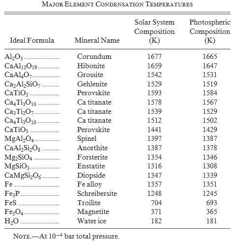

Like you, I found temperature ranges between 150°K and 170°K for the snow line, but no explanation for why those particular temperatures were used. I also found references to 5 AU as being the snow line for our solar system. It was explained to me that distance of 5 AU was only during the protoplanetary disk stage of our solar system, and now the snow line should be between 2.7 AU and 3 AU. Frankly, that does not make sense to me. The snow line should have been much closer to the protostar before the sun began hydrogen fusion than it is now.
According to the above reference the condensation temperature of H2O at 10-4 bar is 182°K. Using the Stefan-Boltzmann law, that would put the snow line at 2.346 AU.
Source:
Solar System Abundances & Condensation Temperatures of the Elements - Katharina Lodders, The Astrophysical Journal, 591:1220–1247, July 10, 2003 [PDF]
Thanks a lot for this info, I somehow missed Lodders paper before.
Although it contradicts a bit some other references that i found (see wiki article), eg see reference (Podolak and Zucker, 2010)
143 K at 3.2 AU to 150 K at 3 AU

|Glitch| said:
It has to be colder than 182°K in space for water-ice to remain stable. That should put the snow line at 2.3 AU, not 5 AU.
Well, this is exactly the confusion, 182K or even if it is 150K (which is at 3AU),
but were does 5AU come from? not clear...
The 182 K value arises from assuming a pressure of 10-4 bar. Most planetary scientists think the pressure was a bit lower than that, resulting in a somewhat lower figure. How much lower? Scientists agree to disagree. That's why you see a range of figures.

Thank you for the detailed explanation. And you were quite correct, I was considering the process more like a switch when a certain temperature was reached at the core. I had not considered that it would be a more gradual process.
The range I most frequently encounter is between 170°K and 150°K, which puts the snow line range between 2.689 AU and 3.453 AU. The range I find for the atmospheric pressure of space is between 1 × 10−4 Pa to < 3 × 10−15 Pa. That is quite a range, and at least 5 orders of magnitude less pressure than 10-4 bar that gave us 182°K for the condensation of water-ice.
