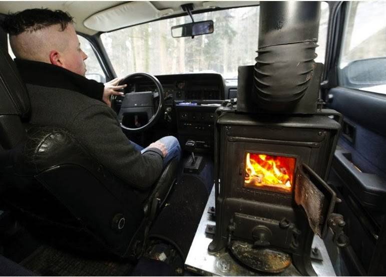

Each with 1500W, on extender... Laid out on the snow... Waiting for the snow-plowers to cut them all...
.... I would rather suggest emergency stoves for EV-s.
Likes OCR
