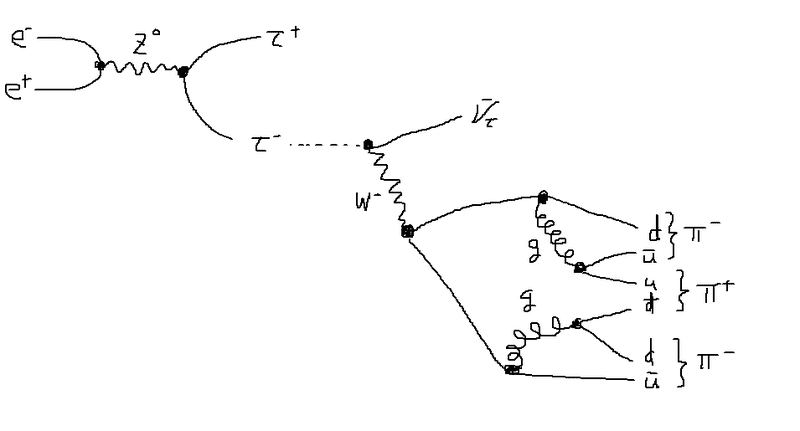

I think an entire summary of the ##e+e-## collider is
[ATTACH=full]178330[/ATTACH]
That is a possible process, right.
