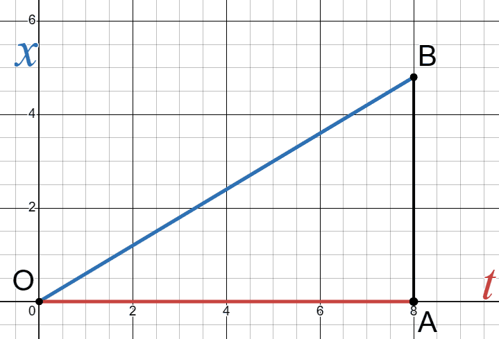

One complaint about "spacetime diagrams" is that they involve a non-Euclidean geometry.
Part of my motivation to start off with using "position-vs-time graphs"
is to point out that
the PHY101 x-vs-t graph also involves a non-Euclidean geometry.
Euclidean trigonometry does not work on the x-vs-t plane.
The Pythagorean Theorem does not work on the x-vs-t plane.
In units where positions are measured in seconds,
and where (OA) and (OB) are the proper-times elapsed along those worldlines,
which are equal [(OA)=(OB)] on a x-vs-t graph
we have
[itex] (OA)^2 +(AB)^2 \neq (OB)^2[/itex].
In addition, in this geometry [Galilean geometry]
(AB) is Galilean-orthogonal to both (OA) and (OB):
[itex] (AB) \perp_G (OA) [/itex] and [itex] (AB) \perp_G (OB) [/itex].
So, using a "PHY 101 x-vs-t graph" already uses a non-Euclidean geometry.
Admittedly, we learn to read off the information without being aware of this non-Euclidean geometry.
But maybe being aware of it could help one understand spacetime-diagrams in special relativity.
In this Physics 101 context, how are ##x## positions in, say, meters converted to positions in seconds?
How is this "proper time" defined in a Physics 101 context? Is it distinct from the absolute time of Newton?

If the goal is just to understand 1-D non-relativistic motion,
then a spacetime viewpoint is probably unnecessary.
If the goal is to understand spacetime kinematics,
then I think it is useful to find ways to build up
to the spacetime viewpoint in special relativity (and in general relativity).
One such way is to suggest that the PHY101-x-vs-t graph already has
some of the features of the spacetime diagram for special relativity.
  • As mentioned, the x-vs-t graph already has a non-Euclidean geometry
    because of the way it is designed and used.
    Such a non-Euclidean geometry is not being "added"...
    rather, it is being "revealed".
  • The expression of lengths in terms of a time does not imply the introduction of
    a physical universal speed... In the context of non-relativistic physics, one could use
    any speed [chosen by convention] to describe a length in terms of a travel-time using that speed.
    It is done in this context to set up the possibility of trying to do some kind of metrical geometry
    using common units on the x-vs-t graph.
  • In "Galilean spacetime" (which could be googled) one could associate a universal speed [which is invariant under Galilean transformations].
    That speed is infinite, which could be visualized as the "opening up of the light-cone" as the invariant-speed in special relativity (called the speed of light, but maybe should be called the maximum-signal-speed) is increased to infinity in the "non-relativistic limit".
  • For me and my approach, the origin of these ideas about and specific features of the Galilean spacetime can be traced back to the mathematician I.M. Yaglom (which is mentioned in an old thread https://www.physicsforums.com/threads/going-from-galilei-to-minkowski.930035/ ), which was discussed in a textbook by G.G. Emch mentioned in that thread [search for these names there].
    Yaglom's idea is based on "Galilean geometry" as one of the nine "Cayley-Klein geometries" in the plane. In the context of physics, one can look at Yaglom's "A Simple Non-Euclidean Geometry and Its Physical Basis" (1979).
    My approach for the teaching of relativity that builds on that idea can be found
    at AAPT Topical Workshop: Teaching General Relativity to Undergraduates (Syracuse, 2006)
    in a poster that I presented:
    "New Ideas for Teaching Relativity: Space-Time Trigonometry" (2006) https://www.aapt.org/doorway/Posters/SalgadoPoster/SalgadoPoster.htm
    You can see some of these ideas implemented in my Desmos visualization
    robphy's spacetime diagrammer for relativity v.8d-2020 (time upward)
    https://www.desmos.com/calculator/kv8szi3ic8
Likes renormalize

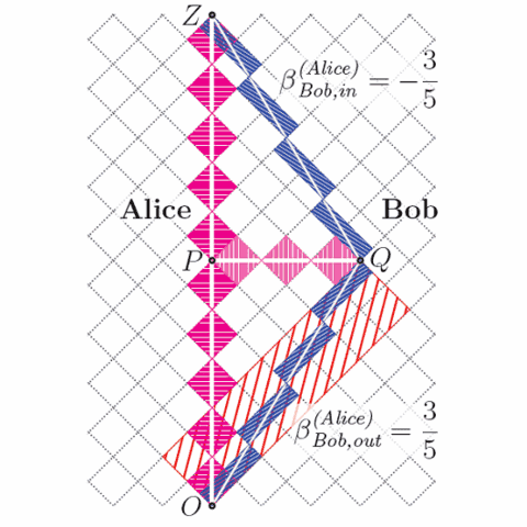

In the "Relativity on Rotated Graph Paper" approach, the goal was to
decorate already existing spacetime diagrams [with t-upward]
with the ticks of light-clocks to reveal a computational method involving
light-cone coordinates and counting areas of causal diamonds.
In more recent introductions to my approach, I start with y-vs-t with t on the horizontal axis,
then eventually moving the t-axis to the vertical axis to match typical relativity diagrams.
pervect said:
Still, it wouldn't hurt to stack multiple light clock diamonds to represent multiple ticks of a single clock. The only real issue here is basically how to do the stacking.
The light-clock diamonds are traced out by the light-signals in a longitudinal light-clock
(which is different from the transverse light-clocks seen in the textbooks).
So, the "stacking" comes naturally from the progression of the ticking longitudinal light-clock.
The pre-cursor to counting longitudinal light-clock diamonds on a rotated graph paper
came from my visualization of a ticking "circular" light-clock.
"Visualizing proper-time in Special Relativity"
https://arxiv.org/abs/physics/0505134
Physics Teacher (Indian Physical Society), v46 (4), pp. 132-143 (October-December 2004)
( the videos use v=(4/5)c; the images are for v=(3/5)c )
(images are from my article
https://arxiv.org/abs/1111.7254
Am. J. Phys. 84, 344 (2016) [ https://doi.org/10.1119/1.4943251 ]
and from my insight
https://www.physicsforums.com/insights/spacetime-diagrams-light-clocks/ )
pervect said:
The "ruler" part seems lacking in exposition as I think about it more. Basically the idea is that the representation of a ruler on a space-time diagram is a group of parallel lines - a pair of parallel lines for a unit ruler, or unit rod. If we keep the idea of "stacks", then "stacks" of "clocks" allow us to measure larger units of time, while "stacks" of "rods" similarly allow us to measure distance.
I have recently referred to "ticks" (along timelike lines) and
"space ticks" (along spacelike lines), which I quickly shorten to "s-ticks" and to "sticks".
So that I can describe displacements in terms of "ticks" and "sticks", e.g,
3 sticks every 5 ticks describes the velocity of (3/5)c.
With "sticks" laid out end to end (like one would do with a meterstick")
we could measure a length in units of the "stick".
A key idea of the approach is that
the tick of a longitudinal light-clock provides the prototype cell
that can be used to tile spacetime (lay out a grid)...
and thus provide a set of coordinates
for the inertial observer carrying that longitudinal light-clock.
Furthermore, once the grid of diamonds is set up [hence the rotated graph paper],
it becomes easier to perform radar measurements
and visualize the results.
