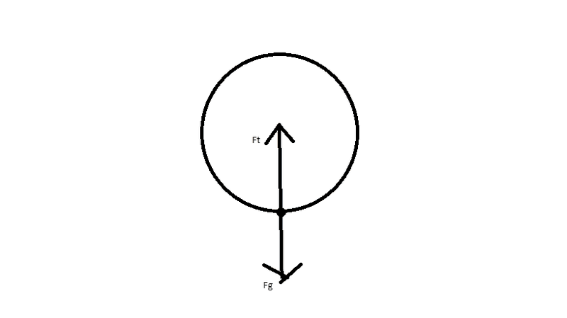

Keys with a combined mass of 0.100 kg are attached to a 0.25 m long string and swung in a circle in the vertical plane.
What is the tension in the string at the bottom of the circle?
Known:
Mass = 0.100 kg
Radius = 0.25 m
Fc = mv^2/r
I know I need to find the velocity at the bottom to put it into the equation.
I just don't know how to figure out the velocity at the bottom, I know the velocity at the top of the circle is 1.56 m/s ^ 2
Any hints or tips on to what I should be doing?

If this is a very simple introductory question you might be expected to assume constant speed, but more likely, the keys have a lower Potential energy at the bottom of the circle, so will have the equivalent increase in kinetic energy - and thus speed.
Handy to note that Fc and Kinetic energy both have mv2 as part of their "formula"
How would I go about finding the velocity at the bottom, I don't think I assume constant velocity.
A FBD I drew up, the dot at the bottom is the keys.
I'd do what PeterO suggests: Conservation of energy.
If you're not supposed to assume constant speed, then maybe you're supposed to assume constant energy in the system.
KEi + PEi = KEf + PEf
Sure, you could instead use kinematics, but conservation of energy is easier.
I am not all that convinced by the diagram. I would prefer FT to appear much longer than Fg as a way of emphasising that you knew it was larger.
I would also never show it finishing close to the centre of the circle, lest someone thought you meant it to be the same length as the radius.

Ok first off, I got the velocity at the top 1.56 m/s from part A of the question.
TO find the 1.56 m/s I did v = [itex]\sqrt{}gr[/itex]
It doesn`t say to assume speed is constant throughout, and I don`t think it is as the keys traveling past the top point will end up going faster because of gravity.
Originally I had though to find the velocity at the bottom of the circle and plug the numbers into Fc=mv^2/r
I was stumped as to how to find the velocity in the first place at the bottom which led me to here.
This is my first unit of my course and I was not introduced to the conservation of energy. I will read up on it and see where it takes me, thank you.
