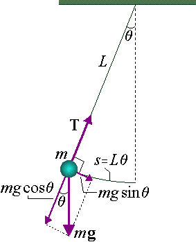

So we can also resolve the forces in the tangential direction, but there is no motion in that direction either so it's not helpful.So, in summary, the tension is not equal to ##mg \cos \theta##. Instead it equals ##mg \cos \theta## minus the centripetal force, which is ##m \frac{v^2}{r}##.

What is the tension in a pendulum? Is T=mgcos(theta) or is T=mg/(cos(theta)) ?
and is the x component of tension is mgsin(theta) and this is the restoring force?

You need to provide the position and the speed of the pendulum, for example, a pendulum at rest would just generate a tension equal to its weight. If you know its speed of swinging, you can use the formula ((v^2)/r)=a_c where v is speed, r is radius and a_c is centripetal acceleration to find out the amount of acceleration towards the centre of rotation, then, use the mass of the pendulum to find the net centripetal force, then, subtract the weight of the pendulum (as a vector) from that force and you get the tension force. If you don't understand anything I said (some or all of that) just ask.

If you're trying to solve a problem it's usually best to resolve the vectors into two components, but not the x- and y-components. Rather, you want one component in the radial direction and the other in the tangential direction. Then apply Newton's 2nd Law in each direction.

Actually the questions aren't a homework question but a confusion I had while solving pendulum problems.
For example in the image you had; I could conclude that T=mgcos(theta)... Because there is not vertical motion.

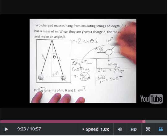

But in a problem I was solving:
T=(mg)/ (cos(theta))

T=(mg)/ (cos(theta)) View attachment 92755
The two situations are different.
For a swinging pendulum, the constant length of the pendulum means that the only radial acceleration is centripetal. Resolving in tne radial direction, ##T-mg\cos(\theta)=\frac{mv^2}r##. (By conservation of energy we can substitute ##mv^2=2mgr(\cos(\theta)-\cos(\theta_0)##.)
For the two hanging charges, there are three forces: tension, gravity and the electric repulsion. If we resolve along the string now we will get a contribution from the repulsion. So instead we resolve vertically and find ##T\cos(\theta)=mg##.

No, the direction of ##\vec{T}## is not vertical, it's towards the center. That's what I meant when I mentioned the radial direction.
Also, there is no motion along that direction, but ##T \neq mg \cos \theta## because the net force in the radial direction is not zero. If it were the pendulum bob would move in a straight line perpendicular to the direction of ##\vec{T}##. The direction perpendicular to ##\vec{T}## is the tangential direction.
I'm confused, then. If that's you solving that problem then you know that ##T=\frac{mg}{cos\ \theta}##. And if that's so, you've answered your own question!
