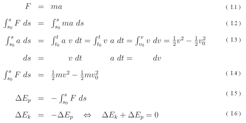

Cleonis said:
I grouped the following 6 equations in an image because that gives me more control over the alignment than I have with MathJax/LaTeX
Sorry, but this is not acceptable. There are ways in LaTeX to align equations.
I have replaced the image with MathJax/LaTeX.
To make up for the unnumbered line in the image version I stated those relations as (1.1) and (1.2)
(I tried to replicate the layout of the image version with LaTeX syntax, so far no luck.)

Cleonis said:
[snip]
(1.7) gives the definition of mechanical potential energy.
From that definition it follows that for any change of mechanical potential energy there will be a matching change of kinetic energy: (1.8).
From that it follows that the sum of mechanical kinetic energy and mechanical potential energe will alway be a constant value.
[snip]
We have, of course, that the definition stated in (1.7) is subject to a condition. The concept of potential energy is well defined only when the outcome of the integration is independent of how the object moves from start point to end point. Stated differently: for any path from start point to end point the outcome of the integration must be the same, otherwise the potential energy is not well defined.
To me, a good presentation of the work-energy theorem
  • begins with Newton's Second Law (with [itex] \vec F_{net}=m \vec a [/itex] ;
    leaving out "net" invites possible misconceptions
    that each force has its own acceleration or has its own change to the kinetic energy)
  • then, "kinetic energy" is then clearly defined here (not pre-supposed from elsewhere)
  • then, expresses the "net work" as the sum of the
    "work due to conservative forces" plus "work due to nonconservative forces" [itex]W_{net}=W_{cons}+W_{nc}[/itex] (while clearly explaining the partition)
  • then, "potential energy" is then clearly defined here for only conservative forces (not pre-supposed from elsewhere)... [ "of course" pre-supposes an understanding that a novice will likely not immediately appreciate]. The minus-sign must be clearly explained.
  • "conservation of total mechanical energy" holds when [itex]W_{nc}=0[/itex] for any path
  • The logic must be as clear as possible.
    I would rewrite some of what you have written as
    $$\begin{array}{rcl}
    \int_{s_0}^s F_{net,s} \ ds
    & \stackrel{Newton II}{=} & \tfrac{1}{2}mv^2 - \tfrac{1}{2}mv_0^2 \qquad \qquad(1.6) \\
    W_{cons} + W_{nc}& = & \Delta E_k\qquad\qquad(1.6b) \\
    (-\Delta E_p) + W_{nc}& = & \Delta E_k\qquad\qquad(1.7)\\
    W_{nc}& = & \Delta E_k- (-\Delta E_p)\qquad\qquad(1.7b)\\
    0& \stackrel{W_{nc}=0}{=} & \Delta E_k + \Delta E_p \qquad(1.8)
    \end{array}$$
