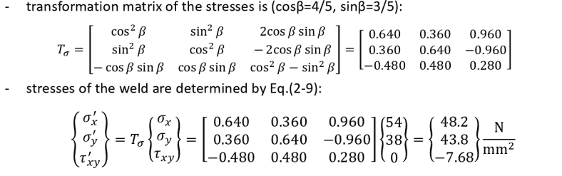

Calcul of stresses
1- σ'x=σx*cos(β)^2+σy*sin(β)^2+2*τxy*cos(β)*sin(β)
2- σ'y=σx*sin(β)^2+σy*cos(β)^2-2*τxy*cos(β)*sin(β)
3- τxy'=-σx*sin(β)*cos(β)+σy*sin(β)*cos(β)+τxy*(cos(β)^2-sin(β)^2)

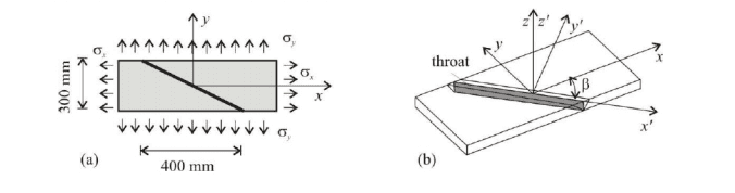

Hi! i have this exercise and solution :
Exercise:
steel plate given in figure (a) is joined by an inclined butt weld ,the plate is subjected to tensile stresses in both x and y directions, σ(x)=54 N/mm^2 and σ(y)=38 N/mm^2 ,
1) Determine the normal and shear stresses of the butt weld.

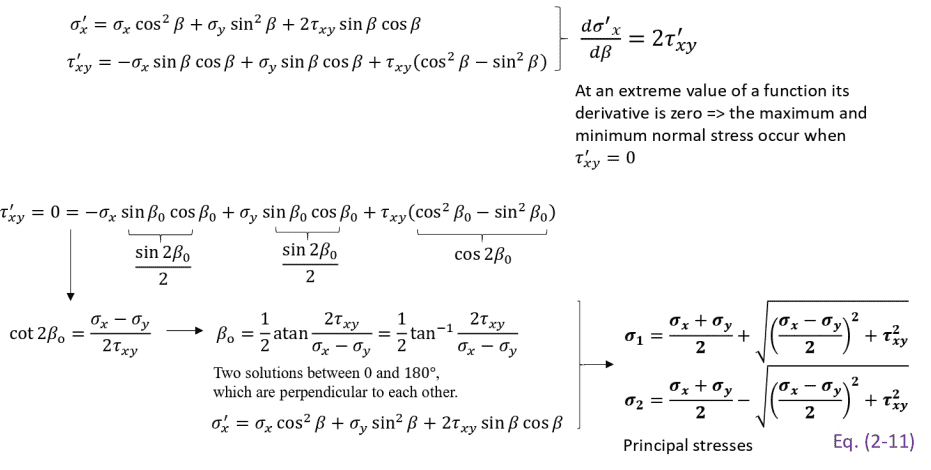

2)second question :
in which direction the stress normal will be maximum ?
My problem: is τxy ( why in first we made it 0 in transformation matrice (and why it's 0) and in second question it's calculed .
As far as I can make out, the first part is a calculation for a special case where there is no applied torque, whereas the second finds the weld direction that maximises stress in the more general case.
In this system, the stress tensor is given by$$\boldsymbol{\sigma}=\sigma_x\mathbf{i_x}\mathbf{i_x}+\sigma_y\mathbf{i_y}\mathbf{i_y}$$and the unit normal to the weld is given by: $$\mathbf{n}=\sin{\beta}\mathbf{i_x}+\cos{\beta}\mathbf{i_x}$$So the traction vector on the weld is given by: $$\boldsymbol{T}=\boldsymbol{\sigma}\centerdot \mathbf{n}=\sigma_x \sin{\beta}\mathbf{i_x}+\sigma_y \cos{\beta}\mathbf{i_y}$$The normal component of the traction vector on the weld is equal to the traction vector dotted with the unit normal: $$\sigma_n=\boldsymbol{T}\centerdot \mathbf{n}=\sigma_x \sin^2{\beta}+\sigma_y\cos^2{\beta}=\frac{(\sigma_x+\sigma_y)}{2}-\frac{(\sigma_x-\sigma_y)}{2}\cos{2\beta}$$The unit tangent vector to the weld is given by $$\mathbf{t}=\cos{\beta}\mathbf{i_x}-\sin{\beta}\mathbf{i_y}$$The shear component of the traction is obtained by dotting the traction vector with the unit tangent:$$\tau=(\sigma_x-\sigma_y)\sin{\beta}\cos{\beta}=\frac{(\sigma_x-\sigma_y)}{2}\sin{2\beta}$$
