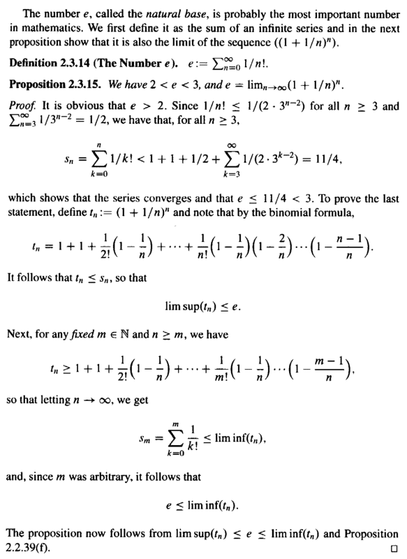

I am reading Houshang H. Sohrab's book: "Basic Real Analysis" (Second Edition).
I am focused on Chapter 2: Sequences and Series of Real Numbers ... ...
I need help with an aspect of the proof of Proposition 2.3.15 ...
Proposition 2.3.15 and its proof read as follows:
In the above proof by Sohrab, we read the following:
" ... ... It follows that ##t_n \leq s_n## so that
##\text{ lim sup } ( t_n ) \leq e## ... ... "
Can someone please explain exactly how/why ##t_n \leq s_n \Longrightarrow \text{ lim sup } ( t_n ) \leq e## ... ... ?
Help will be appreciated ... ...
Peter
Recall that if we have ##t_n \leq s_n## for all ##n## (sufficiently large), then ##\limsup_n t_n \leq \limsup_n s_n##.
But, we know that ##\limsup_n s_n = \lim_n s_n = e##, hence the result.
Likes Math Amateur
Yes ... can now see that ...
Thanks ...
Peter
Likes Nik_2213 and member 587159
