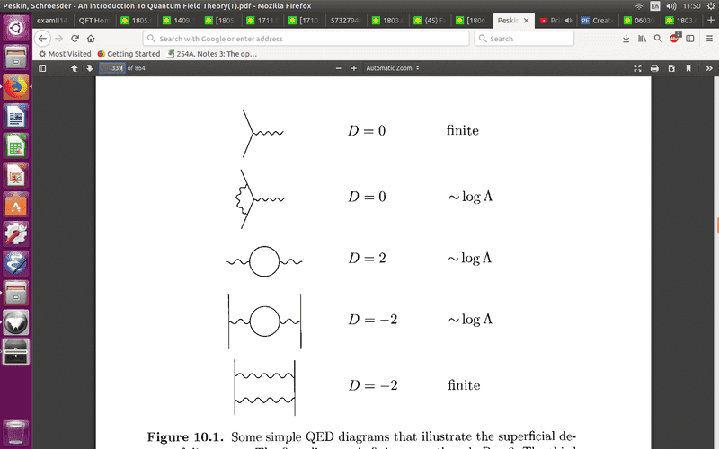

I have in the picture attached a screenshot from Peskin's textbook.
I don't understand how did they get that for the two last diagrams that ##D=-2##.
The question is from pages 316-317 of Peskin's textbook.
$$D=4-N_{\gamma}-3/2N_e$$
where ##N_e##=number of external electron lines;
##N_\gamma##=number of external photon lines.
It seems that for the two last diagrams, we have: ##N_{\gamma}=N_e=2##, which means that ##D=4-2-2*3/2=2-3=-1##, why is it that ##D=-2##?

When they say that ##N_e## is the number of external fermion lines, it means the number of external incoming fermion lines plus th number of outgoing fermion lines. In the last two diagrams, ##N_e=4##.
So ##N_\gamma=0##, why is that? I see two external photon lines.
Is it because the photon lines are connected to the electron lines?
Yes. Note that in the first diagrams you had to use ##N_e=2##
