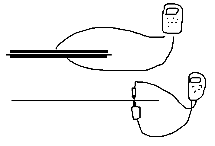

So I have this situation, I'm totally inexperienced with anything electricity. But as faith has it sometimes, suddenly I need a device that would be able to measure the electrical conductivity of a thin film.
Is there anyone who could guide me what would be the essential parts of a system to do this kind of thing? Mainly the "box" that would be sending and receiving the signals - what is it and what are the main characteristics it would need inputing? If I`m buying it - how fancy and expensive can it get? And if I decide to wire one - is it possible to a total newbie without getting myself killed?
Also depending on the above, how do i choose the wiring and material to make contact with the films, etc? I imagine the plates/electrodes would be like a sort of sandwich maker: where I put the film in between them. The films would be of thickness around 1 mm and less, the materials are household polymers: PE, PP, PP, PVC etc..

The conductivity of most common materials can be found from reference sources - no need to measure anything .
If you want to try some experiments then put a small metal plate on top and bottom of a same size sample and measure resistance using a test meter . Simple sums then give the actual conductivity .
I have assumed that you only want to find the through thickness conductivity ?

Yes, I need it for some experiments as the films will be embedded with different substances. Will a standard test meter even work? I mean, aren`t those generally made for more conductive materials?
An off the shelf test meter will measure down to about 50MΩ . Special insulation meters can measure down into the GΩ range .
Once the through thickness resistance of a small sample of sheet material drops much below about 1 MΩ the actual value doesn't usually matter very much anyway in practical applications .

Im not sure about capacitance, probably not something I need. But a question, supposedly the film is uniform in its electrical properties and thickness across the whole specimen. Would I observe any different reading from measuring it the displayed ways?

Also, what you've drawing looks more like a foil. "Thin film" usually implies something deposited on some type of substrate.
The through thickness resistance value depends on the conduction area . So if you have large area contact electrodes top and bottom the resistance will be lower than if you had small area contact electrodes .
If you are working on some idea or actual device where this problem matters then tell us how it works and we'll probably be able to give you more focussed answers .
It is a film - its a transparent polymer slide with a thin film of particle coating on top
1) Yes I would want the surface conductivity
2) No specific contacts, plain surface area is all I got
3) Yes
4) I expect 0.01 μS - 1 S/m
5) ~ 0.1 - 10kHz
6) Uncertain at the moment, I would like to know my options and get away with the least amount of spending.

From that I expect you should be measuring conduction along the film on one polymer surface.
The type of measurement, DC/AC, the frequency and what voltage and current to use will depend on the film material. If it is a carbon or inert metal film then DC measurements will probably be OK. If the film is an ionic gel then you will need to use an AC measurement with carefully regulated voltages to prevent electro-chemistry or polarisation while making the measurement.
For inert films you could start experimenting by placing two parallel electrodes on the film surface. The electrodes would be about the same length as their separation. The electrode separation should be maybe 100 to 1000 times the thickness of the film. Doubling the electrode separation doubles the resistance, doubling the electrode length halves the resistance, so for a thin film, the scale would not be important so long as the electrode separation to length ratio remains constant. In effect you will be measuring the relative thickness of the film.
You will need some way to maintain contact along the full length of the electrodes. That will require a flexible pressure pad or flexible electrodes. You should make some form of simple electrodes and start measuring resistance with a cheap digital multimeter. Let us know what range of resistance measurements you get.
The geometry of the fringing fields at the ends of the electrodes, their proximity to the edge of the film and contact resistance will cause some variation in readings. If higher accuracy is required there are ways to eliminate those variations.
