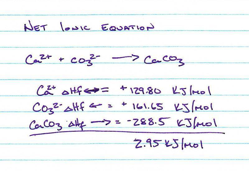

You have all the info I believe...Look at hess's law and at the net ionic equation. I have posted what I believe the answer to be...
Please don't give final answers, that's not how the forum works.
When you mix diluted solutions there will be no precipitate. So while you can be right guessing what the question author had on mind, it is not a correct answer to the question as worded.
