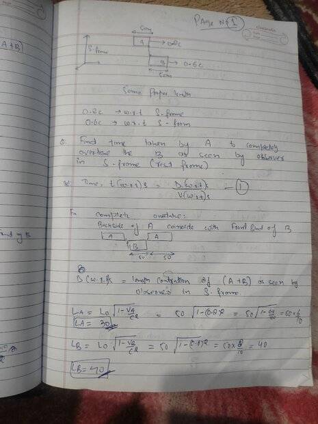

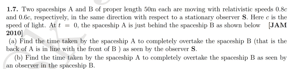

The first part I have calculated is as follows::
Length of A seen by S =30m
Length of B seen by S=40m
In S frame,
Time for front of A and B to come in same line 0.8ct=40+0.6ct...t=200/c
From the above position time for back end of A and front of B to come in same line 0.8ct=30+0.6ct...t=150...
therefore total time for overtake is 350/c...
For the second part ...
From B frame ,A is approaching towards it with velocity 5c/13
The length of A as seen by B is 12*50/13=46.153...
Therefore time taken to completely overtake A as seen by B is coming to be...
1..Time taken by front of A for traveling to the front of B is 50/(5c/13)=130/c...
From the above position time taken by back end of A for traveling to the front of B 46.153/(5c/13)=120/c..
Therefore total time taken for overtaking is 250/c...
Are these two calculations done correct??

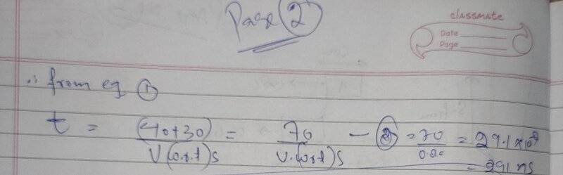

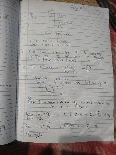

Correct way, t for A to completely cross B as see from. S or wrt s frame= distance which A has to travel for complete overtake divide by velocity of A seen from s with which it has to trave this distance
t=Length contraction if A + length contraction of B that is length seen from s divide by 0.8c velocity of A with which it has to travel this distance as seen from s
t=30+40/0.8c=70/0.8c= 29.1 x 10 power minus 8=291 nank second. You can check the answer key..

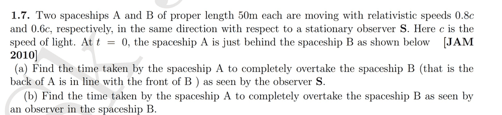

The calculation for part a) is simply ##\Delta t_S = \dfrac{30m + 40m}{0.2c}##, where ##0.2c## is the speed with which A is overtaking B, as measured in frame S. That gives ##\Delta t_S = 1.17 \times 10^{-6}s##.
The calculation for b) involves either the Lorentz transformation or velocity addition. In either case, I think the answer of ##\Delta t_B = \dfrac{250m}{c} = 8.33 \times 10^{-7}s## is correct.
