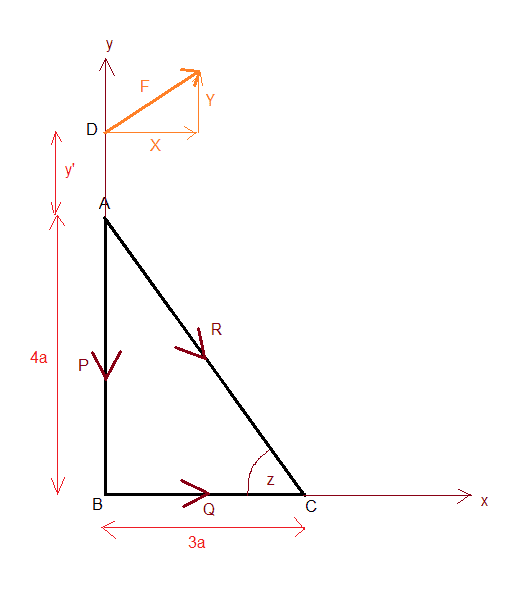

Could I please ask for advice with the following:
ABC is a right-angled triangle in which AB = 4a; BC = 3a. Forces of magnitudes P, Q and R act along the directed sides AB, BC and CA respectively.
a) Find the ratios P:Q:R if their resultant is a couple.
b) If the force along the directed line AC is now reversed, find in terms of P the magnitude of the resultant of the new system.
Part a) is done (with the help of others on this forum) but I'm stuck on part b)
Book abswer is: 35P/12
Here's my working:
In the diagram F is the resultant. I assume it's line of action to pass through (0, 4a + y').
Hypotenuse = 5a
cos(z) = 3/5
sin(z) = 4/5
Resolving horizontally:
Q + 3R/5 = X
Resolving vertically:
P + 4R/5 + Y
So I need to calculate sqrt(X^2 + Y^2) in terms of P only, so ideally I would replace R and Q with equivalents in terms of P.
Taking moments about A:
4aQ=-Xy'
Taking moments about B:
-3R/5*4a = -X(4a+y')
which gives:
12Ra/5 = X(4a+y')
Taking moments about C:
3aP=-X(4a+y')
EDIT. I see that my moments about C are wrong, I failed to take into account the moment of Y about this point. Am continuing to work on this. Should be 3aP = -X(4a+y') - 3aY. Still leads me to R = -5P/4
These last two lead to R = -15P/12 = -5P/4
So I have R in terms of P but I still need Q in terms of P and this I can't see how to do. I tried moments about D but all derived relationships lead me to 0 = 0.
Thanks for any help.
You don't seem to be using the ratios of the forces you found in the first part.
I don't think taking moments in the second part will be helpful.
But aren't those ratios predicated on the assumption that the resultant is a couple? The phrasing of the second part doesn't suggest to me that I can assume a resultant couple now that the force along AC has been reversed.
EDIT: Ok I see that the result about the ratio of P, Q, and R is indeed still valid as R still has the same magnitude because it has only had it's direction reversed.
So I still have P/Q = 4/3 and Q/R = 3/5
(because the answer to part a) is that P : Q : R = 4 : 3 : 5)
Proceeding as before:
Q + 3R/5 = X
P + 4R/5 + Y
But now I know that Q = 3P/4 and R = 5Q/3 and so R = 5P/4
This gives 3P/4 + 3P/4 = X and so X = 3P/2
and P + P = Y and so Y = 2P
and so magnitude of resultant = sqrt(X^2 + Y^2) = sqrt(9P^2/4 + 4P^2) = sqrt(9P^2/4 + 16P^2/4) = 5P/2
Which is not equal to book answer of 35P/12
Thanks for any verification,
Mitch.

There is a slightly easier way. Since the net force was zero, reversing R must lead to a net force of 2R=5P/2.
I have no idea where 35P/12 could come from.
Thanks very much for your reply and confirmation of the answer,
Mitch.
