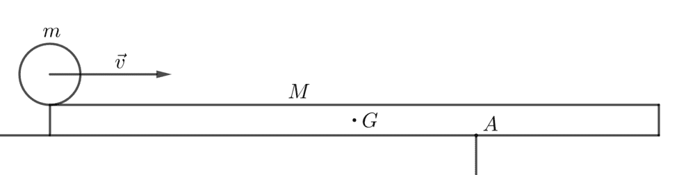

A uniform rectangular rod of length ##L##, having mass ##M## is placed at the edge of a frictionless table so that some portion of the rod rests on the table, and the other portion extends out of the table, and its center of gravity ##G## is a distance ##x## away from the edge of the table.
A block of mass ##m## is initially placed at the far end of the part of rod resting on the table, and given a velocity ##v##. If the coefficient of kinetic friction between the rod and the object is ##mu##, what must be the minimum value of ##v##, so that the rod can be made to topple over the table?

Here is a diagram of the situation.

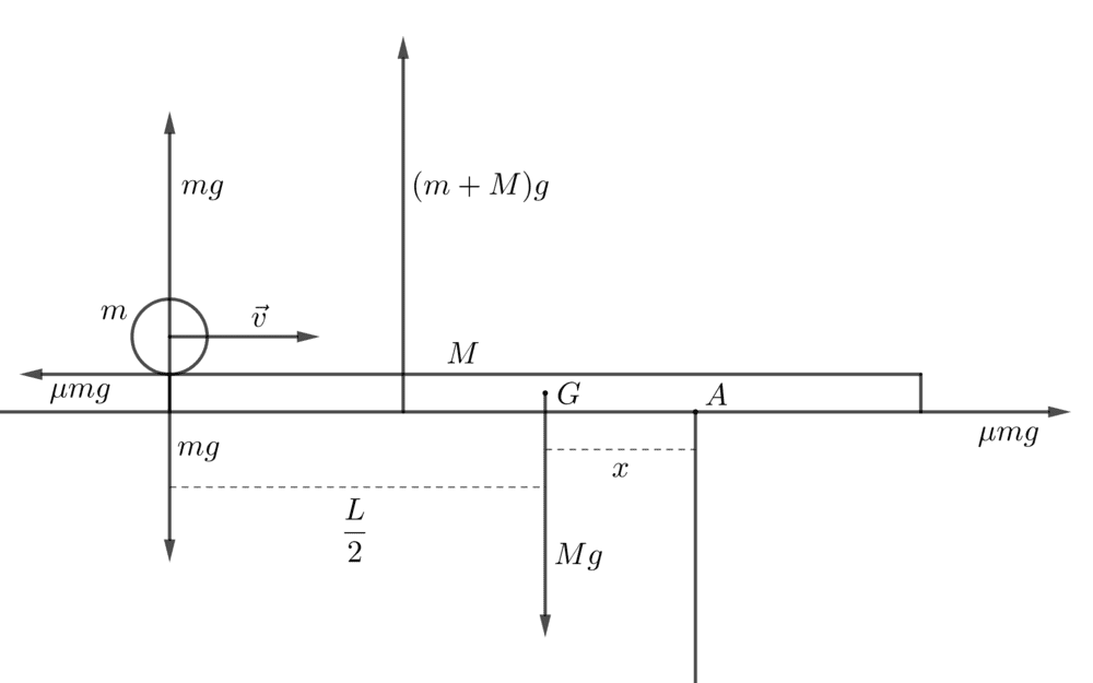

I first marked the forces acting on the system.
I understand that for this rod to topple over, there must be a net moment about point ##A##. But how exactly should I approach this problem?
Isn't it so, that irrespective of the velocity given to the block, at some point both the rod and block will acquire equal velocities as a result of their acceleration and deceleration, and then just continue moving forward at that velocity?

the table is frictionless the center of mass of the system moves towards the edge of the table... what could stop it?
Likes SilverSoldier
SilverSoldier said:
If ##t## is the time that the block will take to come to rest,
As you noted, when it has the same velocity as the rod the acceleration will cease. It will never come to rest in the lab frame.

I believe the question has an error in it or something then. Anyway, the velocity ##\sqrt{\mu g\left(x+\dfrac{L}{2}+\dfrac{Mx}{m}\right)}## I have found is the velocity that must be given to the block so that the system will be on the verge of toppling over, when its center of gravity will have reached the edge of the table?
Not sure what you mean. It is always true that the system will be on the verge of toppling when its mass centre reaches the edge.
What you have found, I think, is the minimum velocity such that the block stops sliding before the system topples.
Another reasonable interpretation is to find the minimum velocity such that the block arrives at G before G reaches A. I.e, it topples before it would have done without the block.
Btw, your diagram shows a ball or cylinder, not a block.
Oh yes. I did mean to say that. I just noticed that I had left the "block stops sliding" part in my previous reply 🤦‍♂️😜.
If put another way, this means to find the velocity so that when the block stops moving, point ##G## and the ball would both be exactly above point ##A##?
Well, it was just easier to draw a circle than a square 😇. It hasn't got to do anything with rolling.
SilverSoldier said:
If put another way, this means to find the velocity so that when the block stops moving, point G and the ball would both be exactly above point A?
Yes.
