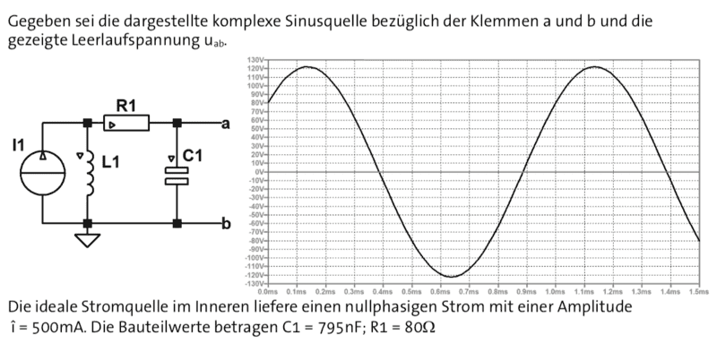

Total current needs to go through the inductor L1, How ?
In summary, the question is what do I need to do on clamp 'ab', so that the total current only goes through the Inductor L1. You will need a second inductor parallel to the capacitor C1, and the impedance between nodes a and b must be infinite at a specific frequency to get all of the current from the current source to flow through the inductor.
Etech_Soffy
Summary:: So the question is, what do I need to do on clamp 'ab', so that the total current only goes through the Inductor L1.
I know the must be a second inductor parallel to the capacitor C1, but i don't know why.
Can someone please explain.
I also included the german question under the picture.

This is a standard series resonant LCR circuit. You'll find lots of links on the web about it's analysis.
I don't think I understand your real question in English. Sorry I don't read German and can't use google translate on an image.
There will always be some current in the C1 branch, except at one or two specific frequencies. The first is 0, i.e. DC, when there is nothing else connected between a and b. DC current can't flow through a capacitor. The second may be at a frequency where the shunt impedance between nodes a and b is infinite, that is the only way to get zero current. So I'm guessing the question is find the impedance Z to connect between a,b that makes the parallel combination of Z and C1 infinite at a specific frequency. You can solve this using the complex representation of impedance (phasors).
Is this a homework question? What have you tried in writing equations for this problem? What is the impedance of a parallel combination of Z (an unknown impedance) and C1.

Yes you a right. I am looking for Z and i already know it has to be an inductor. And my question is, why the impedance between a and b is infinite when putting in an iductor.
No it is not a homework, it is was in the examination last year.
So Z has to be L2 (i think) (complex): Z(all) = R1 + C1 || Z = R1 + 1/ ( 1/jwC1 + jwL2 )

If you want the input impedance seen at a-b, that will be ##Z_C // (Z_R + Z_L)## since the impedance of the ideal current source is infinite.

Yes, but since you want infinite impedance in the network to the right of L1, you can ignore the series R. The only way to have infinite impedance is to get that from the load and the capacitor. So if ZL||ZC=∞, then (ZL||ZC)+R=∞
##Z1||Z2=\frac{1}{\frac{1}{Z1}+\frac{1}{Z2}}##
Fix that and keep going. Your headed in the right direction. How would you get 0 current in that branch of the network?

The illustrated complex sine source with regard to terminals a and b and the illustrated open circuit voltage Uab are given.
The ideal internal current source delivers a zero-phase current with an amplitude T = 500mA. The component values are C1 = 795nF; R1 = 80 ohm.
b) <M10> * What measures at gate a-b can be used to ensure that the entire current of the ideal current source (in the steady state) flows through coil L1?
If necessary, calculate the required component value. (4 points)

The only way that all of the current from the source goes only through the inductor is if the current is DC.
What would happen if an inductor was connected to port ab, that was resonant with C1 at Fo = 1 kHz ?

No (in theory), because an LC tank with no losses has infinite impedance at the resonant frequency. The trick is to get the load current to cancel the capacitor current.

Every specification but the frequency?

The sinusoidal plot is part of the data set.
It does not pass through zero at time zero, so the student must look at the first and third zero crossings to see that the period is 1 msec = 1 kHz.
