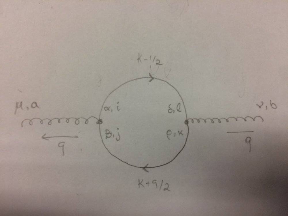

I'm working out the quark loop diagram and I've drawn it as follows:
where the greek letters are the Lorentz and Dirac indices for the gluon and quark respectively and the other letters are color indices.
For this diagram I've written:
$$i\Pi^{\mu\nu}=\int_{}^{}\frac{d^4k}{(2\pi)^4}.[ig(t_a)_{ij}\gamma^\mu].[\frac{i[(\not\! k-\frac{\not{q}}{2})+m_1]}{(k-\frac{q}{2})^2-m_1+i\epsilon}\delta_{il}].[ig(t_b)_{kl}\gamma^\nu].[\frac{i[(\not\! k+\frac{\not{q}}{2})+m_2]}{(k+\frac{q}{2})^2-m_2+i\epsilon}\delta_{kj}]$$
In Peskin & Schroeder's Introduction to QFT it is said: "a closed fermion loop always gives a factor of -1 and the trace of a product of Dirac matrices". In short, I can write the above expression as:
$$i\Pi^{\mu\nu}=g^2T_F\delta{ab}\int_{}^{}\frac{d^4k}{(2\pi)^4}\frac{tr[\gamma^\mu.((\not\! k-\frac{\not{q}}{2})+m_1).\gamma^\nu.((\not\! k+\frac{\not{q}}{2})+m_2)]}{((k-\frac{q}{2})^2-m_1+i\epsilon).((k+\frac{q}{2})^2-m_2+i\epsilon)}$$
where ##T_F## is the Dynkin index in the fundamental representation I get after contracting the generators and deltas.
What I'm having a hard time with is on how to explicitly write the Dirac indices in each gamma matrix and slashed momenta in order to get something of the sort, e.g, ##(matrix)_{ii}=tr(matrix)##.

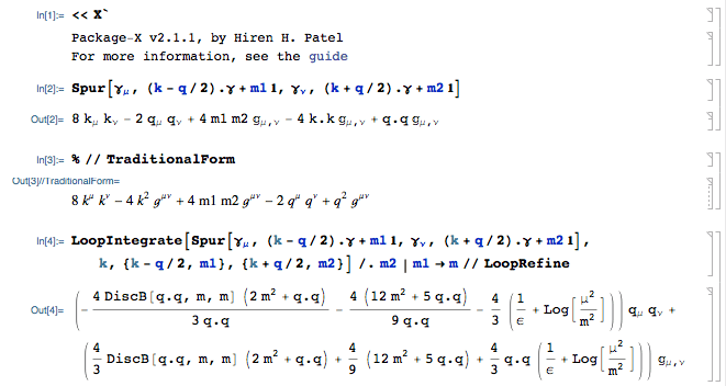

I have written a Mathematica program called Package-X that can help you with your Dirac traces and loop calculation. I suggest after completing the calculation by hand, you check it with the output of Package-X.
Here is what the calculation might look like in your Mathematica notebook.
Copy the following into a blank Mathematica notebook for editable code:
Trace-PackageX.nb:
