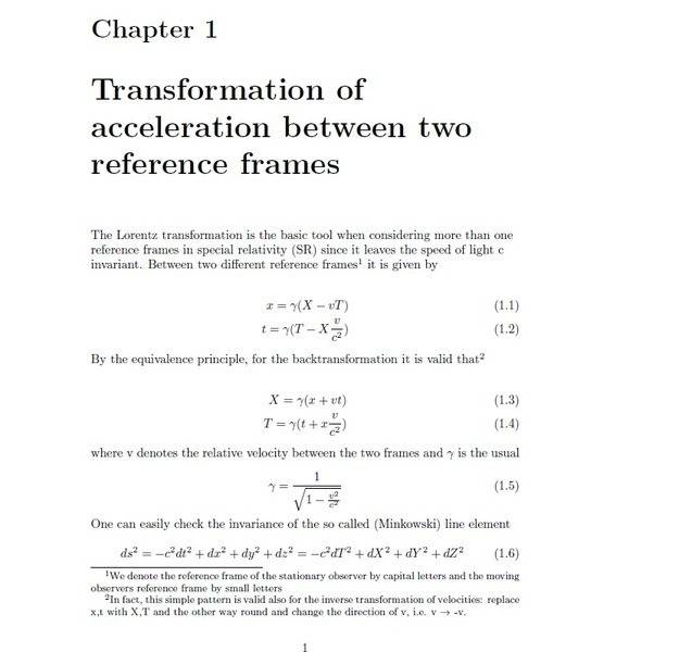

hello
i want to derive the Transformation of acceleration between two reference frames
i searched in internet and found a book but i don't understand just one step
i attach a picture so you can see what i found in the internet

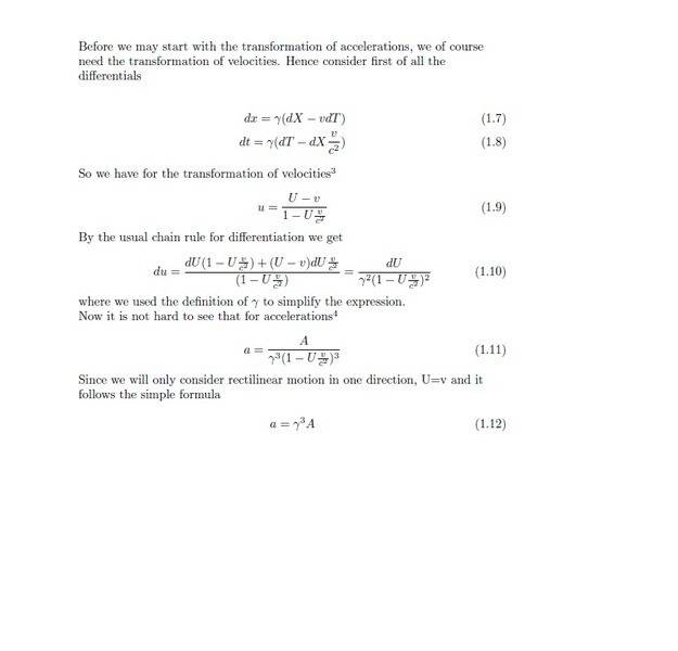

my problem is eq. (1.10) \begin{align}du=\frac{dU}{\gamma ^{2}(1-U\frac{v}{c^{2}})^{2}}\end{align}
how did he get this factor
can you please give me a tip

There's a misprint. Calculus rule is d(x/y) = (y dx - x dy)/y2 where x = U - v and y = 1 - Uv/c2, so the first denominator in Eq.(1.10) should be (1 - U v/c2)2. The numerator is dU(1 - v2/c2), which reduces to dU(1/γ2).

where is this misprint? is it the first denominator? the square is missing right?
my problem is this gamma in eq 1.10 how did he get it? i don't understand it
also the next step with gamma
can you show me how to get it?

There are TWO errors, not one in the book:
[tex]dU=\frac{dU(1-Uv/c^2)-(U-v)(-dUv/c^2)}{(1-Uv/c^2)^2}[/tex]
The final result is correct, the derivation is riddled with errors.

There are TWO minus signs, they indeed cancel each other, so I was a little pedantic. [tex]du=\frac{dU(1-Uv/c^2)-(U-v)(-dUv/c^2)}{(1-Uv/c^2)^2}=\frac{dU(1-v^2/c^2)}{(1-Uv/c^2)^2}[/tex]
But [tex]1-v^2/c^2=\frac{1}{\gamma^2}[/tex]

so now i have to divide both sides by dt to get du/dt=a
but again with this gamma. eq 1.11 i don't understand it

OK, let's help u a little more:
We agree that:
[tex]du=\frac{dU}{\gamma^2(1-Uv/c^2)^2}[/tex]
Now,
[tex]dt=\gamma(dT-dXv/c^2)[/tex]
Therefore:
[tex]a=\frac{du}{dt}=\frac{dU}{\gamma^3(1-Uv/c^2)^2(dT-dXv/c^2)}=\frac{dU/dT}{\gamma^3(1-Uv/c^2)^2(1-dX/dTv/c^2)}=\frac{dU/dT}{\gamma^3(1-Uv/c^2)^3}=\frac{A}{\gamma^3(1-Uv/c^2)^3}[/tex]
If [itex]u=V[/itex] then [itex]a=\gamma^3A[/itex]
