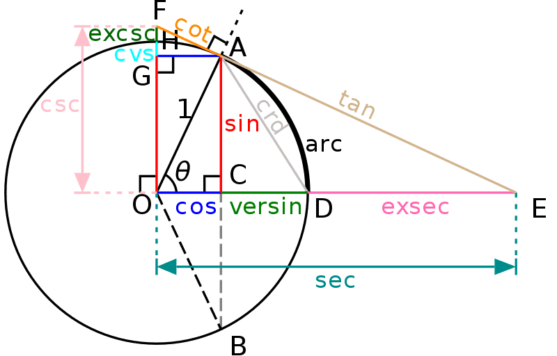

Possibly enlightening...
https://commons.wikimedia.org/wiki/File:Circle-trig6.svg
https://blogs.scientificamerican.co...unctions-your-math-teachers-never-taught-you/
https://www.theonion.com/nation-s-math-teachers-introduce-27-new-trig-functions-1819575558
Likes SammyS and MichaelRocke
