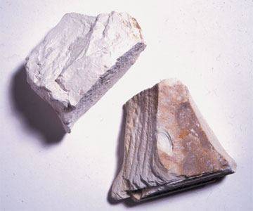

First of all, thank you very much for all this information! Here's an example of what I mean with massive mineral (I learned this term at university, and it's used to define a mineral with no crystal structure visible). https://en.wikipedia.org/wiki/Kaolinite#/media/File:KaoliniteUSGOV.jpg This a Kaolinite sample, but if I look at it for the fist time, I'd call it rock, because it hasn't got any form of crystals in it, at least they're not visible. So I was wondering how I distinguish between a massive, earthy mineral and a rock, with only macroscopic analysis?
Also, I'm a little familiar now with some of the analysis techniques that you mentioned, and I'm capable (but I have very small experience) of using a polarizing microscope and observing the optical sign, and some features of a thin section.
Now, that you mentioned that you are a mineral collector, I must admit that I'm really glad of knowing that, because I have a great passion for minerals, and I'm only doing a single semester course about mineralogy, and I have great fear that with only that little experience that it gave me, I won't be able to realize my little dream of having a collection, studying only by myself. Because I realized, that in order to understand deeply the features of a mineral and being able to distinguish between them, I must have a direct contact with them, and it is also important the presence of an instructor that teaches me how to do that. But I won't have someone to teach no more, because the course came to an end, and I can only learn by myself from now on. So, I was wondering if you have any advice for me about learning by myself without any professional telling me things, if it is really possible, and if there are any sources (books, or anything else) that can help me in that. I acknowledged also that when it comes to buying minerals, unfortunately sometimes sellers can sell "fake" minerals (like synthetic minerals or a kind that looks like another one and so on...), and so I must be capable of recognizing real pieces from others and this is also another difficulty for me that I'm just starting in this field. So any advice, would be gold for me.
Anyway, even if you can't help me in this, I thank you for your attention and your answers.
Sorry here's the kaolinite sample
Whoops. Kaolinite occurs as a weathering, secondary mineral in igneous, sedimentary, and metamorphic formations. Soils may contain kaolin as part of the clay particle fraction of the soil. It is soft, you can usually scrape it with your fingernail. It crumbles, too. If you soak it, it becomes cuttable with a knife - not many minerals do that. It is also similar to several related minerals, that have the same chemical formula.
So it kind of breaks some of the rules of thumb @davenn presented earlier. ( This is one of the reasons mineral identification is occasionally difficult. ) Kaolinite also has the sometimes confusing, but really nifty and useful trait of changing structure when exposed to heat. e.g., making high quality clayware when heated in a kiln.
You picked a bad starting choice for developing sets of rules for distinguishing minerals.

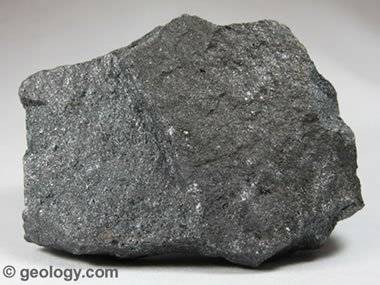

Yes, I know is not a good choice, but the point is that I had problems with it and with other minerals with this "massive" or earthy shape. I'll try to give another two examples, like this piece of magnetite, and this sample of pyroxene. Both of them doesn't have crystals (at least not visible), and are massive, so what I don't understand is how I distinguish between a rock and a mineral that hasn't got any crystals, and it is opaque? For example if I found on a excursion pieces like that, how I can say only looking at them, if they are minerals or common pieces of rocks? Anyway I must say that I don't know much about rocks, I know only about minerals, and when the sample has crystals, or it has metallic luster (or even a non metallic luster and it's transparent or translucent) it's relatively simple to identify it by hardness, streak and cleavage, but when it comes to this samples with earthy luster I'm not even sure that it can be a mineral.
Anyway thanks for your response :)
I see black crystals in the magnetite. Think of crystals that and ant could wear as jewelry, not the gigantic quartz things you see in mineral stores.
They are there as inclusions. An inclusion is a different mineral from the "main background", and can be a small crystal. I'm not helping. I cannot do much for you from here on.
