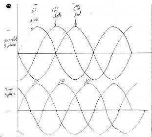

Here is an image that I thought represents the difference between RPC 3ph and true 3ph... is it correct?

Is the image of the waveforms I posted accurate? It demonstrates that the generated leg (2) will never reach the same maximum potential in reference to 1 or 3 as 1 and 3 would reach relative to each other. So say 120v, 1 to 3 can achieve 240 between each other but 2 will never reach 240 relative to any reference...
Your question is more about why 2 legs of the convertor are the same legs as your single phase supply right? Your diagram looks like typical 3 phase.

There are two graphs in the image, one claiming to be a RPC 3ph output (top) and the other to be representative of PowerCo, true 3ph.
I guess my questions are somewhat hinged on the accuracy of that top graph, it is somewhat more clear to me if that is an accurate representation of RPC output. In which case I would think something such as a 3ph motor being driven by a RPC would exhibit rougher operation than compared to running it on PowerCo 3ph.

Again, what is the common point on the scope that displays these waveforms? A true legitimate display of the 3 phases needs the common of the scope to be connected in a symmetrical manner. Wye connected transformers have this as the center node but delta connected transformers need something more creative. I would say that your attachment is a bit misleading. The top one would probably be close if the ground of the scope is connected to the neutral of the single phase supply. However, to have an apples to apples comparison you would need the same connection on one of the center taps of the transformers in the lower display of your attachment. Clearly this is not the case. I have built and used a rotary phase convertor.
The understanding is more important than the application, in this case, for me. Why not look at this in terms of current in each of the legs in relation to time? In true 3ph, current through each leg to the load should oscillate symmetrically in relation to each of the other legs; ∆I = 0 (or Imax) at evenly spaced time intervals, indefinitely, for current in either direction. This is represented by the "true 3ph" illustration above, which I think all of us can agree is ideal 3ph power. So if the other illustration is misleading or inaccurate (because of where the illustrator chose common); my question is what would period of ∆I = 0 (or Imax) look like with an RPC output?

As is pointed out above - the WAY the phases are measured when taking the scope measurement is also important - however I would not call this a common point on the scope - three phase power measurements can not use the scope common point(generates smoke) - and need isolation to be connected to a true scope. If the sketch artist IS using a scope common (on the Neutral of the single phase system) than he could have an RPC - and I do think that is the waveform he would get.
You need ether a true 3 phase neutral -- or three separate phase to phase reading (A-B, B-C, C-A).

The period and frequency will be set by the primary supply. The 120° phase separation of the voltages in the “three phases” generated will be what determines the quality of output balance. That does not require Fourier analysis for a single frequency. It only requires computation of the phasor angles.
If there is no neutral return, then the sum of currents in the three phases must be zero.
What gives? Ideally you generate three phase voltages at 120°. You then load the converter. The voltage phases should remain stable and balanced in phase, independent of load. The load current deviations will then be due to unbalanced load.
If you have an input neutral and an output neutral then you have a terminology problem. You can synthesise a neutral output wire on a 3PH delta connected converter by using a star, = Y, connected three phase transformer wound on a single three legged core. I keep a few 3PH transformers from old equipment for that purpose. Unfortunately you then need an input isolation transformer if for safety and protection the output neutral is going to be connected to the input neutral and ground. It is usually better to wire your rotary converter as a star.
A four channel digital scope will give you a view of three phases relative to neutral=earth by subtracting the neutral channel from the phase channels. A three channel digital scope can compute the average of the three inputs and subtract that from the 3 phases for display. But that requires you select a common reference, ground or neutral for all phase inputs.
You can synthesise an output reference voltage by using three load resistors in a star. But then you need an analogue three phase scope with a floating neutral input that can be subtracted from all phase inputs.
