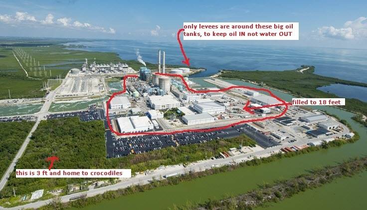

Good question. I just saw on the news that those power plants are being shut down before the hurricane hits. The plant elevation is only 3 feet above sea level, but there are levees around it. I don't know the height of the levees.
It's not levees - the the whole site is filled to 18 feet elevation.
It''s the highest ground for miles, plenty of room for water from Biscayne Bay to run around it.
Likes Jon Richfield, phinds, PFreader and 2 others
