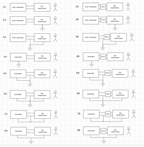

Hello, let's say the AC generator and the washing machine, with a live metal frame due to a fault, are floating-neutral and floating-ground. These are many combinations where both get and get not bonded/grounded. Can anybody tell us in which case the person gets an electric shock when touches the metal frame, and why? The person is standing on the soil with bare feet, and with shoes (to put both cases)
This isn't a homework, it is just that there are a lot of different opinions on the internet and some confusion in me and many people. I added with/without RCD/GFCI breaker cases to make this more complete
thanks
It will depend on how the person is also grounded.
None of your diagrams show a ground for the person, so there would be no ground current or shock.
thanks, I added it
Due to a double-fault, not just a single-fault. Can you comment why it would take a double-fault (at least in the US) to create a shock hazard like this? :wink:

double-fault? can you explain us what is that? only the washing machine has its frame energized in all the cases shown, as can be seen in the diagrams
Safety regulations for appliance design and installation have a goal of not creating a dangerous situation as a result of only a single fault. In the US, it is Underwriters Laboratories (UL) that publishes various design standards, and does testing and qualification of devices to those safety standards.
So for AC Mains powered appliances and instruments, there are regulations for how you handle the AC Mains wiring and the grounding of the devices. For metal body appliances like washing machines, a 3-prong power cord is used so that Earth Ground is available inside the machine. That Earth ground wire must go directly to the metal body of the machine, and be connected with a solid, reliable connection (like a metal stud, washer and locknut). That ensures that all externally-accessible metal on the machine is reliably Earth grounded.
In addition, the AC Mains Hot wire that comes into the machine must go immediately through a fuse and a switch of some kind before going into the power supply. Those connections also need to be very reliable (often made with spade lug type connectors).
All of this is done so that a single fault (a single thing going wrong) cannot energize the metal enclosure of the machine and create a shock hazard. If the Hot wire breaks or falls off of a connection for some reason, if that wire does contact the metal enclosure, it creates a short through the fuse and the fuse blows quickly enough so that there is no shock hazard. If the Earth Ground wire connection breaks or falls off for some reason, the Hot wire is still reliably bonded in the system, so there is no path to energize the floating metal chassis.
So you can see how with this system of safety rules, it takes a double-fault to energize the metal chassis. That is why it is so unlikely and hardly ever happens.

Here is an example of a single fault enlivening any earthed metal appliance.
Imagine the blue CNE/PEN conductor breaks to the left of the link to the earthing conductor. The equipment case is then connected to live through the load and N-E link.
An RCD/GFCI won’t operate in this situation.
This is a very common earthing system in the UK, and is also known as TN-C-S. The risk is commonly mitigated between transformer and installation by using split concentric cable, which has the CNE/PEN conductor distributed as multiple wires around the other conductors, reducing the likelihood of a complete break.
It’s also a concern with EV chargers, since a broken PEN will make the car‘s bodywork live.
