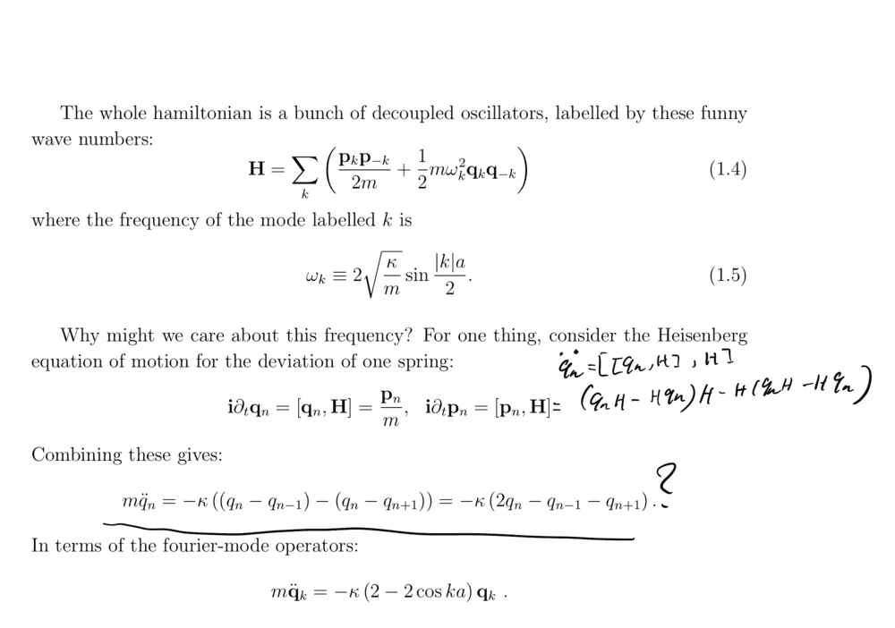

In summary: I don't quite understand how he got the line below.In summary, "He" is referring to the author of a private document on the quantization of elastic waves. By using discrete time approximation and combining terms, the author was able to obtain a second order time expression for the term "##q_n##." This can be further clarified by looking at Kittel's Introduction to Solid State Physics, specifically Appendix C on the quantization of elastic waves.

I don't quite understand how he got the line below. By using discrete time approximation, we can get the second order time expression. But i don't see how by combining terms he is able to get such expression.

Simply substitue the second Hamilton’s equation into the first.
Hint: ##q_n## can be written as a Fourier series with coefficients ##q_k##, and vice versa.
For details see e.g. Kittel, Introduction to Solid State Physics, Appendix C: Quantization of Elastic Waves: Phonons

But I recognize these notes, they are available for free on the author's public website...? But perhaps you have your own reasons for not disclosing, in any case Demystifier's hint will get you in the right direction.
