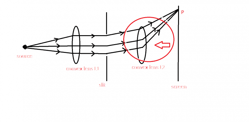

A monochromatic source of light 'S' is placed at the principal focus of a convex lens 'L1'. A parallel beam of light or a plane wave front is incident on the narrow slit represented by AB (its width - 'a')
So, what my teacher did was,
She showed diffraction of the light rays as they pass through the slit.
And then she made the rays to meet at a point 'P'.
Look at the image. Doesn't the convex lens L2 seem to be actually 'diverging' the rays? Shouldn't it 'converge' them?
I'm literally confused about it, because all the books seem to support my teacher.

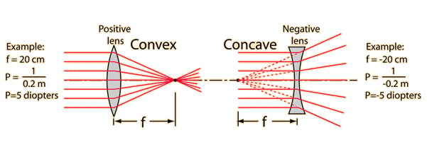

Looks like it's converging to me. In this image, the left lens is converging and the right lens is diverging.
Image compliments of http://hyperphysics.phy-astr.gsu.edu/hbase/geoopt/foclen.html
Likes Prashasti
Yes the parallel rays are converging. They were parallel and are now drawing together.
Does it mean why my teacher did was wrong?
I 'm talking about the second lens...
