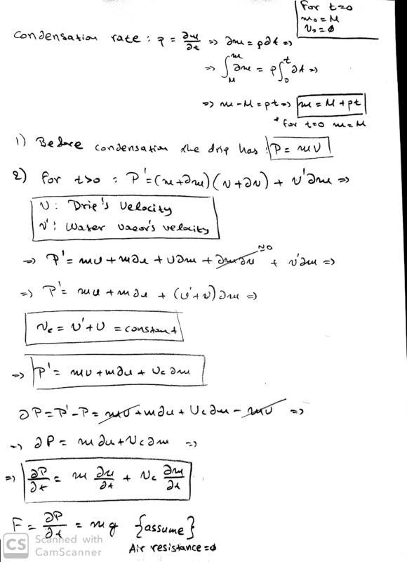

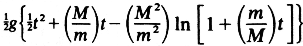

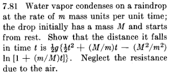

Falling drip surrounding by water vapor. For t=0, initial mass=M and Uo=0. Prove the following equation...
nil
S(t)=
Hi all!
Μy attempt to solve it:
I'm stuck here. An opinion ?
Thanks.

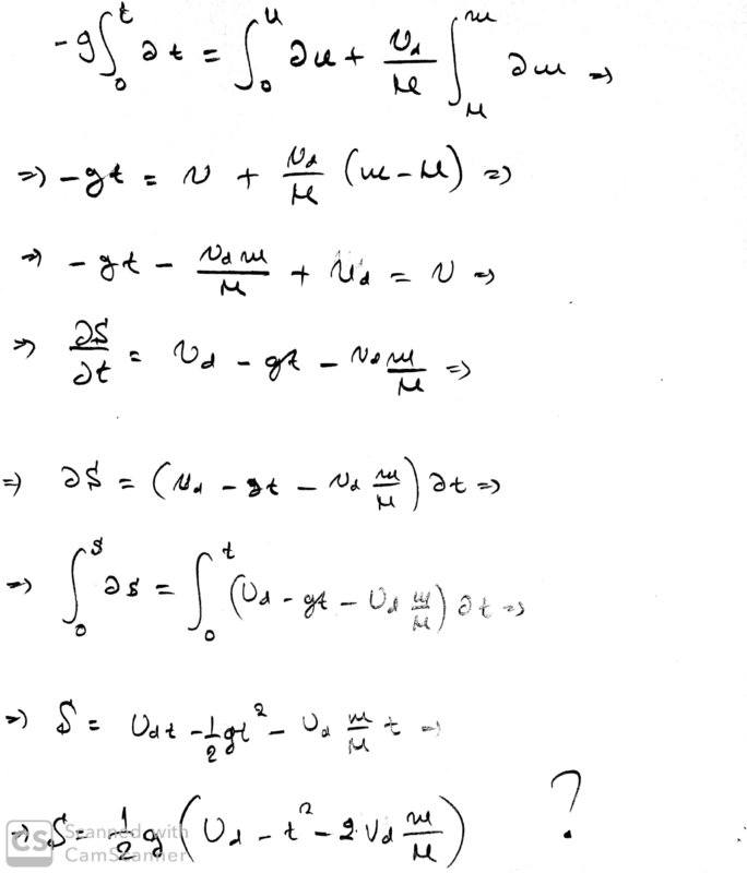

Edit last line:
S=t (ud-(gt/2)-ud(m/M))
* I dont't know what happened there

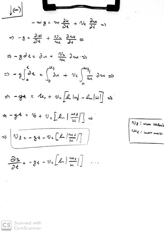

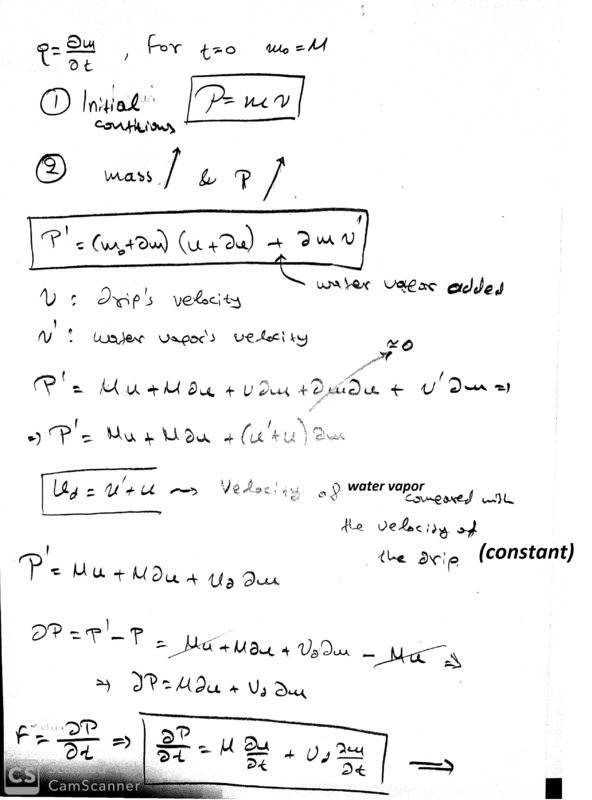

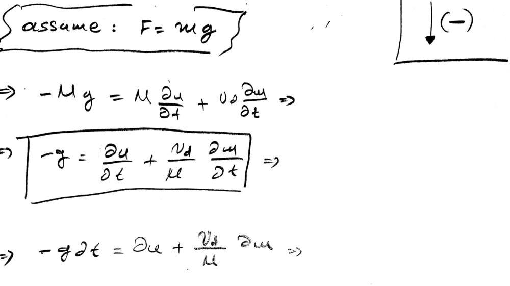

I made a new attempt to solve it, and reading more for those kind of problems. I made some errors at the previous posts, so this is my attempt now:
I'm on the right track ?
Thanks.

This is the description:
From: Fundamental University Fhysics Volume 1 (Mechanics), Marcelo Alonso & Edwart J. Finn
