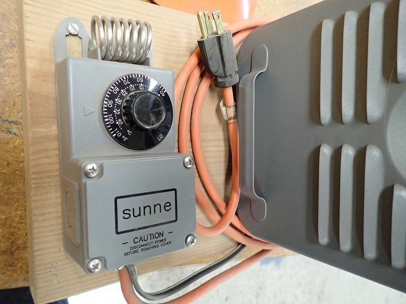

Total heat loss from insulated room = 960 BTUH. Heating the room plus warming 10 barrels at the same time would still have less than 2000 BTUH heat requirement. You could build a room with less insulation, but I do not recommend it. The floor needs to be insulated. Possibly two inches of foam under a double layer of 3/4" plywood. The plywood would be glued, screwed, and have the seams offset.
This heat requirement is far too small for a gas furnace. A possible heater would be a 1000 watt electric baseboard heater controlled by a barn thermostat. The photo below shows a barn thermostat. Note that the thermostat is calibrated to 110 deg F. Barn thermostats are built for use in environments that would kill residential house thermostats.
Do not try to save a few dollars by wiring a thermostat to a milk house heater as shown in the photo. After extended use, the plug connection resistance can increase to the point where the plug insulation melts. Ask me how I know this.
Don't forget a circulating fan. Most box fans or ceiling fans should be designed for continuous use at 95 deg F. I suggest a standard ceiling fan set to blow downward.
