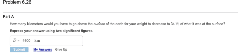

The problem is stated in the picture.
Fg=Gm.1m.2/r^2
I found a similar question where someone wanted to find how high will the weight be half the weight on the surface. Here is one of the answers:
F =G.m1.m2/r^2
F´ =G.m1.m2/r´^2
so F/F´= r´^2/r^2 = (r´/r)^2.
So I tried applying it to my situation. I wrote 34/100=r'^2/(6.38*10^6)^2. Solving for r' I got an answer of x=3.72*10^6meters=3720km. The correct answer of 4600km is displayed in the screen shot attached. I really don't understand how to do these problems, though I do understand that Fg is inverse square proportional to r. Any help would be greatly appreciated. Thanks.

Look again at your F and F'. You have them reversed. Then you will be solving for radius from center of Earth. You need to find height above the surface.

Using your formula, I am still confused. I wrote the equation as F/F'=100/34=r'^2/(6.38*10^6)^2. Solving this for r' I get 10,940 km. I really don't get what I plugged in wrong. F/F' indicated that the original force is around three times greater then the ' force, and r is the radius of the earth.
Have you swopped F and F' ?
As far I understand it should be like this:
$$\frac {F'} F = \frac {G*M1*M2} {r'^2} * \frac {r^2} {G*M1*M2} = \frac {r^2} {r'^2}$$
Now it is important to think as that in the question is written that your weight reduces with 34%, so you can't plug in 34% you need to take care of that. If I do that I come on 4520 km. I think that's correct.

How do you incorporate 34% into the equation without plugging in 34/100 or 100/34 to the equation?
The question states you weight is reduced with 34% so what percentage is left?
You have 66 percent of your weight left. But even if I plug in 66 I get: 66/100=(6.38*10^6)^2/r'^2, getting an r' of 7853km?
$$0.34 = \frac {6380^2} {r'^2}$$
Then you get the distance from the centre of the earth, but they ask the distance form the surface of the earth. I am sorry if i don't explain myself good enough.
I come on 4561 km
Likes AfronPie
I come on 4561 km
Thanks, I made 2 mistakes. I switched F and F', and also I didn't know that you had to subtract the distance 6371km but now I understand. Thanks for your help.

The key is in this problem is knowing that this formula applies from the centre of the mass and the question that was asked was from the surface of the mass.
Well if you swop everything you still come on the same answer:
$${r'}=\sqrt{ {6380^2} * \frac 1 {0.34}} = 10941.6$$
$$10941 - 6380 = 4561.6 km$$
