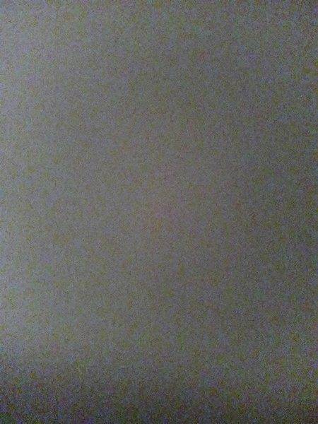

Hi I have a cheap smart phone with a low quality camera when I go to take a picture there is what I would describe as like old television static appearing in front of the image as it appears on the phone screen (although what is beyond it can still be seen). I am wondering if this is just dust particles? or is it disruption in the light caused by subatomic waves/particles?

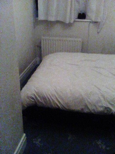

It can be seen on the walls in this picture, in particularly the part in the bottom left. But before the picture is taken then it appears to be moving all over the image at high speed.

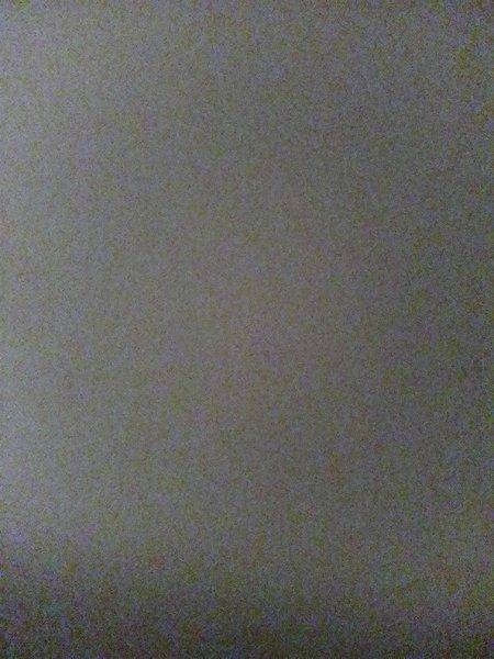

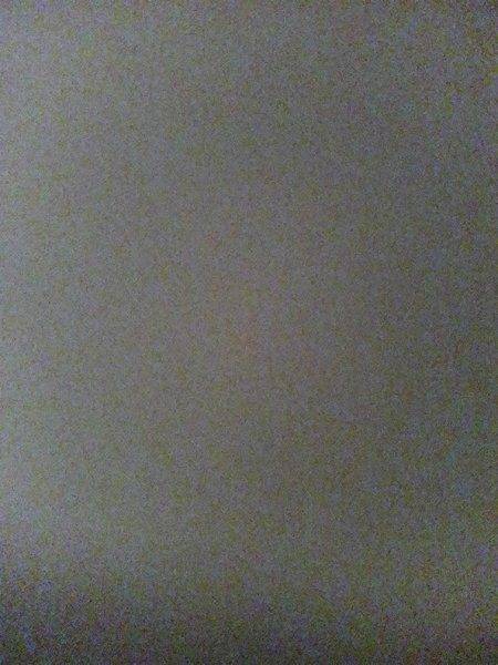

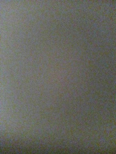

Can you take a few pictures in a row of a blank wall and post them?
Here you go :smile:.

Looks like simple noise in the camera. The conversion between the amount of light hitting a sensor and getting a digital value of that is not perfect, and you get random deviations for each pixel each time you take an image.
I agree, it looks like it is just noise. Noise becomes more visible in darker regions because there is less signal to obscure it and because the gain is higher.
That just looks like a grainy low-light photo. It happens when the camera uses software to amplify the signal, increasing the noise. Does that happen when there is more light?
