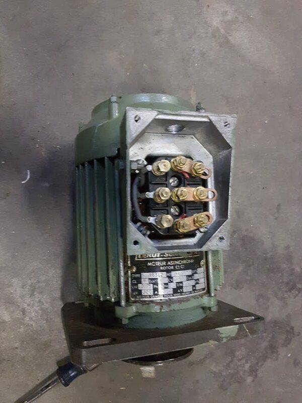

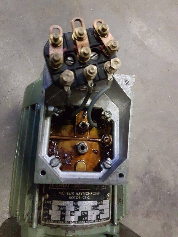

there are only 3 wires in the terminal box!
I'm used to Baldor motors that were dual voltage, they had 9 coil wires and two ways of connecting them for either high or low voltage
Can you show us a picture of the wires connecting to the terminals in the box.
There should be six screw terminals, with a couple of brass connectors.

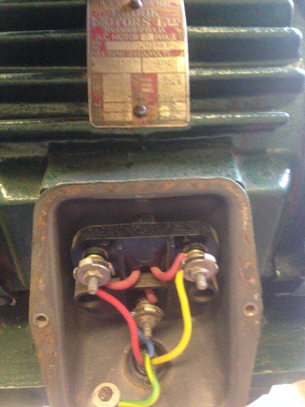

Yup, that's what I'm used to.. Not this one though, Sure it has a terminal block but only 3 wires going to the windings!
I'll try and get a pic in a bit
Looks normal here
But wait a minute...
Likes dlgoff
Guineafowl said:
The junction is either buried in the motor windings (permanent Y, with only three available connections)...
As far as I can see, those black wires are single conductors, and there are no others coming out. The motor must be permanent Y as above, and so configured for the higher voltage.
The terminal block is presumably a standard type fitted to different models. But why the plate suggests dual voltage when it’s not I can’t say. Perhaps someone has been fiddling.

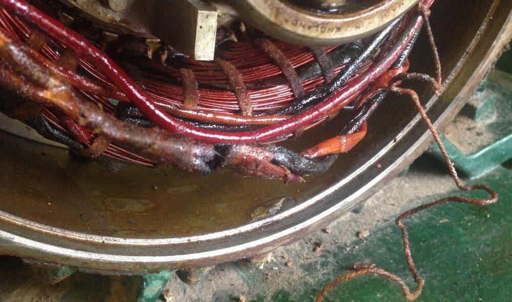

The existing wires seem to come from the back of the windings, so my next move would be to open that side and locate the buried tri-connection (we call it the star point). This can be separated and the three resulting wires brought out to the terminal box.

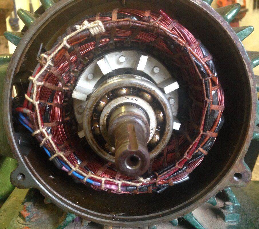

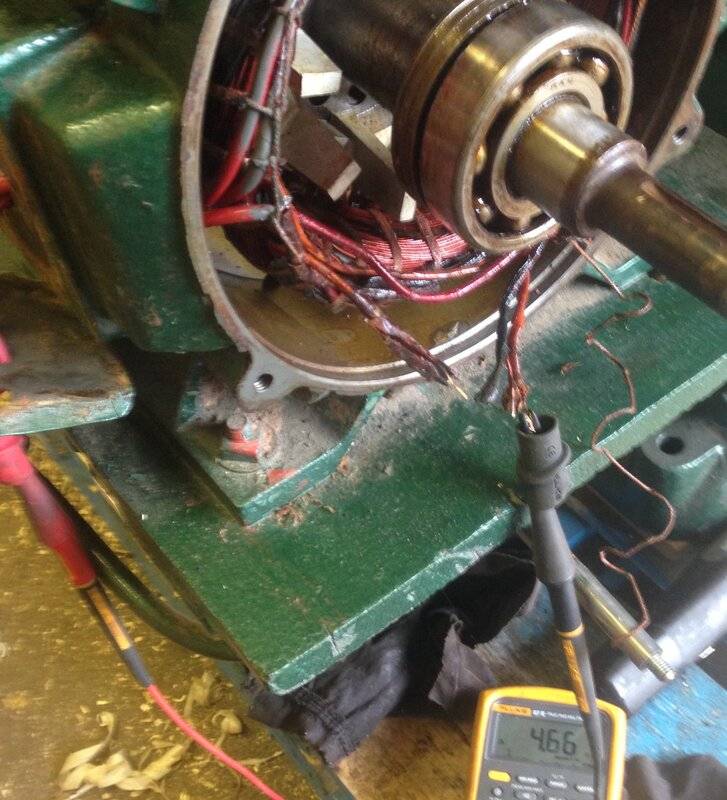

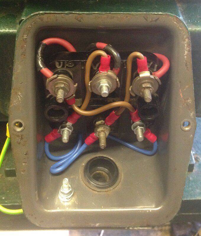

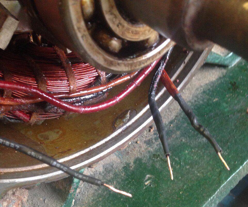

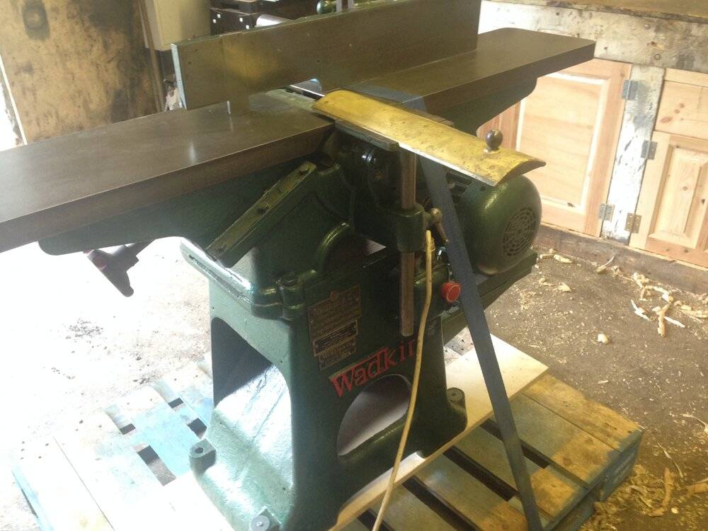

As it happens, I’ve just this week done this to a 1932 Wadkin planer (jointer, in your parlance):
This was originally fitted with a 460V DC motor!At some point, it’s been fitted with a 3ph one.
Only three connections, so permanent star:
A likely candidate for the star point - three wires coming together from places about 120deg apart:
Resistance of each to its outer connection is about 1/2 that between outer connections:
Ends prepped:
Wires brought out, then loom re-stitched:
Ready for dual voltage:
