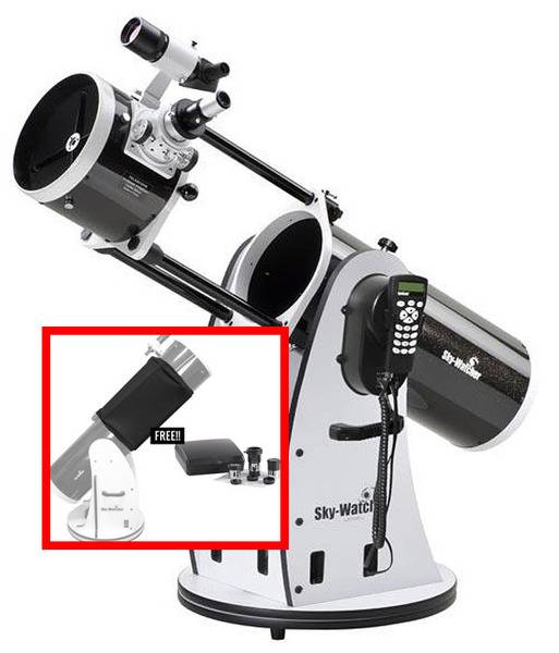

if 1) ... get the biggest dobo you can afford ... the bigger the better and a low f ratio F7 or less
eg ... an 8" dobo with GOTO
https://www.bintel.com.au/product/skywatcher-8-inch-goto-collapsible-dobsonian/?v=7516fd43adaa

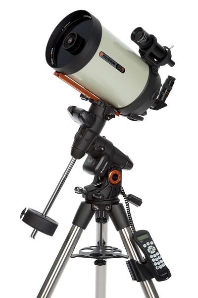

if 2) ... get a decent scope ... Newtonian, Schmidt-Cassegrain, refractor ... the biggest you can afford
eg ...
8" Schmidt-Cassegrain
https://www.bintel.com.au/product/celestron-advanced-vx-8-edgehd/?v=7516fd43adaa
Note that this has a f10 focal ration which is not brilliant for astrophotography

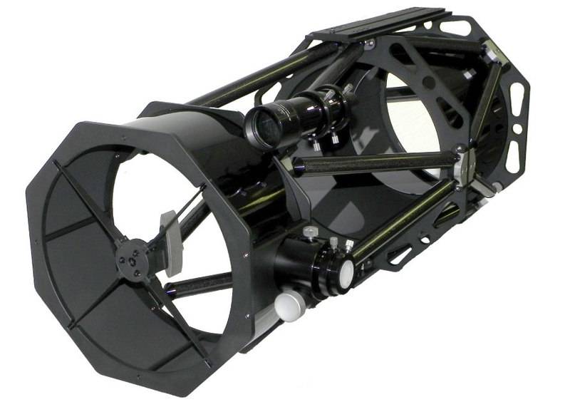

but you could get a faster optics tube assy and put it on the same mount and have an awesome astrophotography
set-up eg ...
https://www.bintel.com.au/product/bintel-gso-bt252-f4-carbon-truss-Newtonian/?v=7516fd43adaa
10" f4 primary mirror Totally awesome ! ... if I had the money, I would own one myself ... a serious "light bucket!"
The carbon fibre framework will make it reasonably light ( for its size) but strong and easy to handle

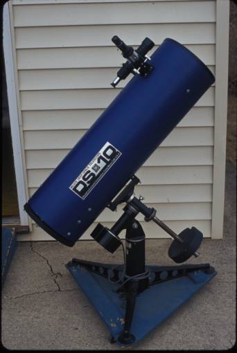

The largest scope I have owned was also a Meade ... the DS 10
This is a generic image from google. was a nice light bucket f4.5 focal ratio ( that was also throughout the 1990's
