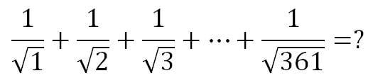

i have thought about that for serval days= =
please help
It is 35.565955205923352
But I can't tell you about [tex]\sum_{2}^{n} \frac{1}{\sqrt{n}}.[/tex]
how about steps?
Just entered into the calculator.
i want solving it without cal
In what form do u want the answer.
you can approximate the sum by integral 1/sqrt(n) between 1 and 19.
notice that 19^2 is 361
that is 2(19-1) = 36
The answer is close enough
HOW come to this step?
[tex] \sum_{1}^{361} \frac{1}{\sqrt{n}} [/tex]
is approximately equal to
[tex] \int_{1}^{361} \frac{1}{\sqrt{n}}. [/tex] =[tex]2(\sqrt{a}-\sqrt{b})[/tex]
=[tex]2(\sqrt{361}-\sqrt{1})[/tex]
=36
Why do you think there is any answer better than 35.565955205923352 ??
I don't think there's an analytical solution, but you can approximate it.
First approximation is integral,

[tex]\sum^{n}_{k=2}\frac{1}{\sqrt{k}}=\int^{n}_{k=2}\frac{dk}{\sqrt{k}}+\frac{1}{2\sqrt{n}}-\frac{1}{8n\sqrt{n}}[/tex]
And after some tiresome calculation for n=361
[tex]=35.1977[/tex]
Which I think is a pretty good approximation, if only to show that the operator thing is correct.

You can also use the first 5 terms of the http://planetmath.org/encyclopedia/EulerMaclaurinSummationFormula.html" (i.e. the integral, the terms involving the first derivative, and the terms involving the second derivative) to approximate the sum as follows :
[tex]
S_n = \sum_{i=1}^n \frac{1}{\sqrt{i}}\approx 2\sqrt{n} +\frac{1}{2\sqrt{n}} - \frac{1}{24n\sqrt{n}} -
\frac{35}{24}
[/tex]
The result is then :
[tex]
S_{361} \approx 36.56797638
[/tex]
The error relative to the true result is about 0.0055%.

All I am doing is substituting [tex]f(n) = 1/\sqrt{n}[/tex] into the Euler-Maclaurin formula. This time from Mathworld (since the formula is expanded in full), the http://mathworld.wolfram.com/Euler-MaclaurinIntegrationFormulas.html" formula can be written as :
[tex]
\sum_{k=1}^{n-1}f(k)=\int_0^n f(k) dk-1/2[f(n)-f(0)]+1/(12)[f^{'}(n)-f^{'}(0)]-1/(720)[f^{'''}(n)-f^{'''}(0)]+1/(30240)[f^{(5)}(n)-f^{(5)}(0)]-1/(1209600)[f^{(7)}(n)-f^{(7)}(0)]+...
[/tex]
Note that i have written [tex]1/2[f(n)-f(0)][/tex] instead of [tex]1/2[f(n)+f(0)][/tex]. The former is consistent with http://en.wikipedia.org/wiki/Bernoulli_number" .
Then I make the approximation :
[tex]
\sum_{k=1}^{n-1}f(k)\approx \int_0^n f(k)dk-1/2[f(n)-f(0)]+1/(12)[f^{'}(n)-f^{'}(0)]
[/tex]
Then I substitute [tex]f(k) = 1/\sqrt{k}[/tex], and then add [tex]f(n)[/tex] to the result since the summation in the formula is up to [tex](n-1)[/tex] where as we want it up to [tex]n[/tex]
All you have to do is to subsitute [tex]f(k) = 1/\sqrt{k}[/tex] into the formula above, and verify my result.
