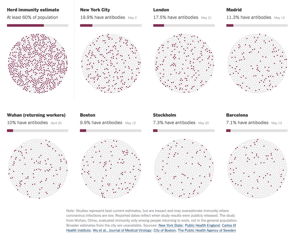

This NY Times article discusses herd immunity with respect to the corona virus.
I like the visual representation of herd immunity they presented:
The first case (herd immunity estimate) shows the relative difficulty a virus would have in blindly blundering (as viruses do) onto a new host (with out immunity (either from a vaccine or from immunity built up from a previous infection)) so that it could reproduce.
The greater the number of people in a population with immunity, the better the herd immunity effect.
