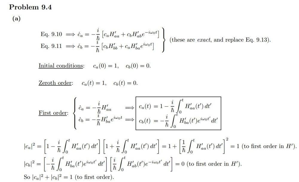

I'm learning Griffiths' QM (3rd edn).
In Chapter 11 (Quantum Dynamics), there is an expression I'm not familiar with:
## \left| C_b \right|^2 = \left[ - \frac i \hbar \int_0^t H'_{ba} \left( t' \right) e^{i \omega_0 t'} \, dt' \right] \left[ \frac i \hbar \int_0^t H'_{ba} \left( t' \right) e^{-i \omega_0 t'} \, dt' \right] =0 ## (to first order in ##H'##),
where ##H'## is a time-dependent perturbation of a two-level system.
There are some other places where the expression of "to the first order in H" appears. I can't remember anywhere I have learnd the expressions in calculus or other mathematics courses.

Hi, DrClaude. I'm still confused. Shouldn't ##\left[ \int H'_{ba} \left( t' \right) \cdot \int H'_{ba} \left( t' \right) \right]## mean second order in ##H'##?

Yes, it is the perturbation theory. Well, the expression is from the solutions of the 2nd edn. The problem is 9.4.
Here is the solution.
Would you mind look at it in your freetime?
Thank you so much!
I get it now. It is ##|c_b|^2 = 0## to first order in ##H'##.

I'm sorry I still can not see how can it be first order in ##H'##. How does ##\left[ \int H'_{ba} \left( t' \right) \cdot \int H'_{ba} \left( t' \right) \right] ## relate to the first order in ## H'##?

No. As you noticed yourself
This expression is 2nd order in ##H'##, therefore, to first order, ##|c_b|^2 = 0##.

:woot:Ah...I understand it now. Thanks!
