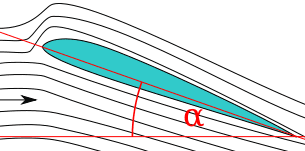

When looking at the shape of an airplane wing from the side, like here
I'm wondering what makes the air move faster above the wing. I have some questions about this:
1. It rather looks like there is a longer distance for the air to travel above the wing than below it, but wouldn't a longer travel distance rather imply less speed? Why doesn't it?
2. It also looks like the air must "bend" more when going on top of the wing than below it (more easily seen here:
), wouldn't that also create more air resistance on top of the wing and thereby less speed? Why doesn't it?
3. What is it that makes the air move faster above the wing?
This comes up regularly on PF.Look at the "related discussions" at the bottom of the page and click on the links.
To answer question 1 specifically, since there is a huge amount of nonsense about this on the web: if you look at the animation, the air takes a different amount of time to travel over the top and bottom surfaces of the wing, so trying to find a simple connection between the speed and the shape, or the length of the surface, is irrelevant.
The shape is not very important except for reducing drag. Planes can fly upside down. Even a flat plate will produce plenty of lift, if it is at an angle to the air flow.
I agree with AlephZero. There are many different ways to think about how wings work but many are over simplifications. Including this one...

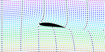

The above surface of the wing have a longer distance for air to flow over.But it takes the same time.So the air flow faster on the above side
It actually doesn't take the same time -- the two airstreams don't align at the end, the way they started. That's actually one of the common myths about the way wings work.

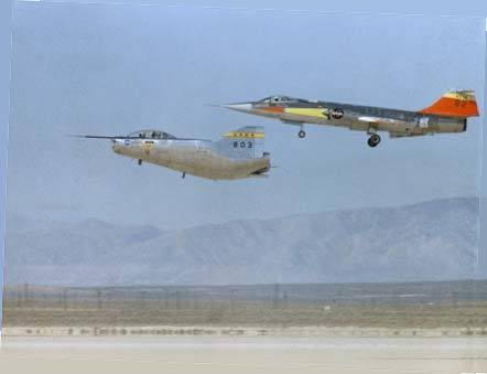

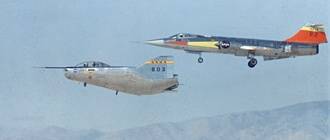

This pre-shuttle re-entry prototype glider (a later version had rocket engines and could reach mach 1.6) should dispell any longer path or hump on the top theories. It's an M2-F2 on landing approach with an F-104 Starfighter along side.
Looks can be deceiving: The top is the longer path -- that's not what the equal transit time misconception gets wrong. In that photo, you can't tell what the angle of attack is, so you don't know where the stagnation point is, so you can't tell which path is longer. Things change when you look at this diagram:
The top looks flat in your picture, but it really isn't -- the down-sloping trailing edge is just hidden behind the tail. And what they define as the 0 aoa line is actually 5 degrees up, geometrically.

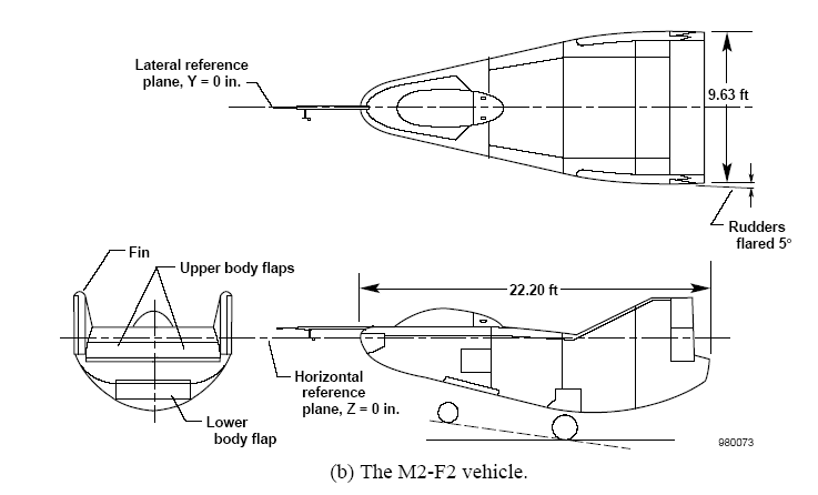

I'll see if I can find the specs again, but I recall that about 2/3rds of the leading portion of the bottom section is a half cone shape that curves back upward and transitions to a flat section that ends at the blunt trailing edge opening in the back where the rocket nozzles were placed in the M2-F3 version. The top half is flat and tapers downwards at around 40% from the leading edge. A good portion of the central part of the bottom surface is a longer path than the top, but not all of the bottom portion.
The main differences from a conventional wing is that the "hump" on the bottom is larger than the "hump" on the top, and the blunt trailing edge needed for the rocket engines. The lift to drag ratio for such a design isn't that great, but that isn't needed for re-entry from space, and the vehicle would need to be able to withstand hypersonic speeds during re-entry, although this was never tested (max speed with rocket engines was mach 1.6).
Here's a newer image I found and rotated 2 degrees to the right to get the ground (note the white "stripe" at the bottom of the image) to appear horizontal, although if the pitcure wasn't taken directly from the side of the aircraft, then the ground apparent orientation can be affected. At higher speed, less angle of attack would be needed. My guess is that the upper front surface was probably angled downwards a bit at high speed (mach .8 or greater).
Here's are links to NASA web pages with images of the M2-F2 and M3-F3:
NASA M2-F2.htm
NASA M2-F3.htm
In any case, even if you could show that that's an exception, exceptions don't prove rules, they are exceptions.
The point in this case is an exception that disproves a false premise (the false premise that the larger hump has to be on top, but I'm not sure about the longer path has to be on top, since only a portion of the bottom surface of the M2-F2 involves a longer path.) It might be possible to disprove the longer path premise with a wedge shaped wing (at a specific air speed, it would have a horizontal top and an inclined bottom, equal taper at the trailing edge) although it wouldn't be practical from a lift to drag standpoint.

It doesn't take the same time. The air above the wing reaches the trailing edge before the air below the wing.
https://www.youtube.com/watch?v=6UlsArvbTeo
rcgldr said:
The point in this case is an exception that disproves a false premise (the false premise that the larger hump has to be on top, but I'm not sure about the longer path has to be on top...
Sorry, but that is a new false premise that you are falling for now. We didn't talk about "larger hump", only longer path. Not the same thing. The problem is that the wing shape is deceiving. While we can't really tell for the M2F2, you can tell for a flat-bottomed wing. The minds-eye draws the chord line geometrically to separate the top and bottom surfaces, but the reality is that the stagnation point moves as the angle of attack changes, which means the top and bottom surfaces aren't separated by the same line all the time. So it only looks like the path is shorter on the bottom: it isn't necessarily true and isn't true under a very negative aoa.
Ie: flip a flat bottomed wing over and it can fly inverted, but only at a high aoa.
yup, which is exactly what the animation in the OP also shows :smile:
