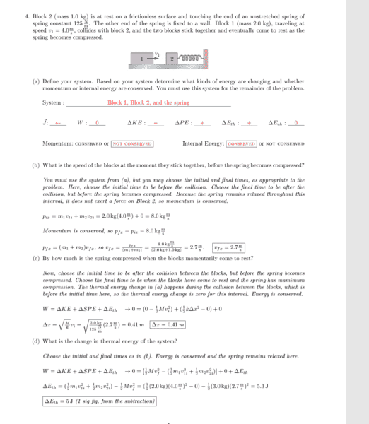

I am going through the final exam problem sets right now and just looked at the answer key and wondering where in this system there could be thermal energy? while i was working through the problem i assumed no thermal energy because of the frictionless floor. where in this system is there thermal energy coming from?
also wondering why momentum was not conserved
The two nicely fit together: in the inelastic collision (the blcks stick together) some kietic energy is absorbed and thus converted to thermal energy.
Good luck with your exam...
PS lousy picture to read for a helper, but I don't want to upset you at this time ...
