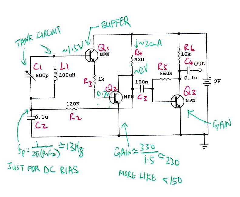

I do not see a modulator on this receiver. Can anyone let me know where it is?
I am trying my hands on building receivers and transmitters. For now I would like to build this receiver here:
now I see that the 500pH inductor in parallel witht he 200uH capacitor are in charge of filtering the unwanted frequencies. The top-left NPN is in my guess an emitter follower to prevent loading? I've no idea what the middle NPN is for. I also have no clue what the right-most NPN is for but my guess is as an amplifier simply because I assume every radio needs an amplifier of some sort (I am probably wrong). The demodulators I am used to seeing are the ones that use diodes. Now since BJTs are sort of like diodes then I assume that you can possibly use them for demodulation as well? I don't know really. Any help is appreciated.

Not quite... The 500 pF variable capacitor is in parallel with a fixed 200 uH inductor.
That parallel LC circuit is tuned to resonanate at the receive frequency.
The inductor is probably also being used as the antenna.
I believe the first two transistors form a low frequency darlington pair that detects the audio envelope of the RF.
I'm not sure how a Darlington pair would do envelope detection, but I could be missing the obvious. Also, the feedback is confusing me a bit.

I ran across this, C1 L1 forms the tank circuit. Q1 is just a buffer. Q2 is just a gain stage. Q2 using Q1 to form a DC bias circuit for Q2 to operate. I put in the approx voltages. R2 and C2 form a low pass filter to create the DC bias of about 1.5V at the base of Q1 which gives about 0.7V at base of Q2. You can see the approx DC voltage at different points.
I don't see the demodulate circuit as C3 is just an AC coupling capacitor, it is like a high pass filter. I just see Q3 forms a second gain stage.
This is really old style circuit that I only saw in really old books, the bias is at the mercy of the beta, it is very inaccurate. I wrote the approx gain in green.
You do need some non-linear function to demodulate AM, so looking for a diode is a great guess. I'm too lazy to analyze this one, but I think @Baluncore must be correct, the darlington stage is probably clipping or saturating and doing the detection.
Q2 sure don't have a lot of headroom to swing, you can see the collector is sitting about 2V at best, it does not have much room to go lower. I don't know that can rectify the signal. I would expect some sort of low pass filter to get rid of the RF. there's none. R2 C2 is way way too slow for anything other than serving as DC bias.
Gain and coupling are corrected by adjustment of the 120k feedback resistor.
This is a regenerative circuit, so you must model it as an amplifier with high-pass feedback that almost oscillates. The low-pass bias will be dependent on signal strength. Think of the bias envelope as providing the audio output.
Regenerative and super-regenerative receivers can be incredibly sensitive and selective, with a minimum component count. That is why they are seen in old books. Components are now so cheap that component count is irrelevant and receivers must be easy to use by the unskilled listener.
https://en.wikipedia.org/wiki/Regenerative_circuit
My first receiver was a crystal set with one germanium diode. My second was a three tube super-regenerative, one vacuum tube did all the RF, another was the audio amplifier, the third was a full wave power rectifier.
120K with 0.1uF?! the corner frequency is 1/(2pi x 120K x 0.1uF) = 13.3Hz. How is this have anything to do with RF? I don't get it. It is a low pass just to set up the DC bias for Q1 and Q2. At 130Hz, you can ignore the 120K and just the 0.1uF capacitor. I hope when we say RF, that's over 100KHz. At 100KHz, the reactance of 0.1uF is 15.9ohm. With the 120K resistor as voltage divider, I am pretty comfortable you can ignore the feedback from the 120K resistor,

I believe you were complaining that the front-end bias was at the mercy of the darlington beta.
The 120k and 0u1F is correcting for that. The circuit note advises changing the value from 120k if there is not enough headroom. The bandwidth of the bias control must be sub-audio or it will cut the low frequencies.
There is also stray capacitive and inductive coupling everywhere in that front-end, including the antenna coil and the power supplies.

Actually I was thinking about Q3 that using the base current to set up the voltage across the 560K that set the collector voltage. Any change of beta change the collector voltage. I assume the output voltage at collector Q2 is still small, don't need a lot of room to swing, but amplified by Q3, the voltage at collector has to be more significant. To increase headroom for Q2, increase R3 can do this too. creat more voltage drop across R3 to raise the collector voltage of Q2. Either way, it again depends of the base current of either Q1 or Q2, which is unreliable.
At less than or about 1MHz, stray inductance and capacitance should not be very important as the circuit is not very high impedance. When I think RF, it's like at least 100MHz to GHz and beyond. But of cause, if it is like the radio in the older days that use pcb without ground plane, components were standing up so one lead was long and all, that might introduce unforeseen issue. AND people don't have a habit of bypassing the power supply.
I still don't get where is the demodulator is.
The base-emitter junction of Q3 is a possible candidate. It is non-linear and the input is modulated by low impedance RF.
