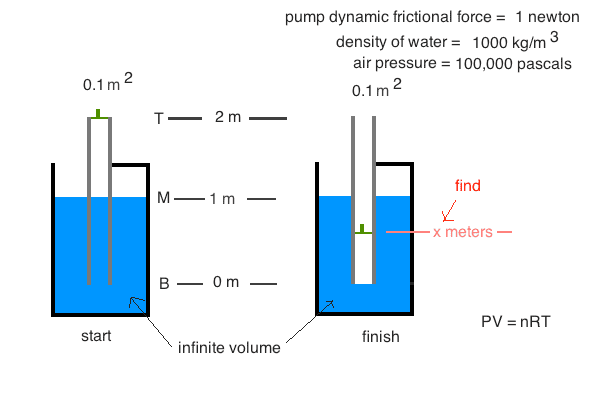

After a few hours of thinking about it, I think it would make an interesting homework problem:
Of course, the friction is always the booger in the perpetual motion scheme of things.

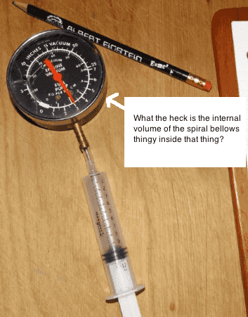

BTW, I just spent a couple of hours doing experiments on my very ancient pressure measuring device, to determine how accurate it would be if I were to do such an experiment.
ps. I decided that the maths was quite a bit too difficult, and I therefore cheated, as usual.
Answer: 3.6 cc
