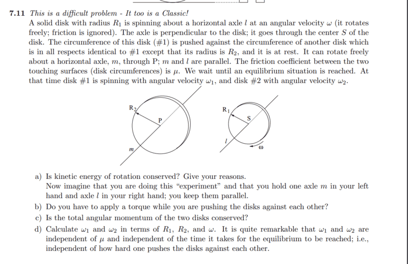

please check the screenshot.
I have two questions: which don't need any calculation yet:
1. Why is angular momentum of the two disks not conserved?? The friction between is internal no? In the solution it said that there is ang. momentum conserved (neither kinetic of course)
2. What is actually meant with 'an equilibrium situation reached'?
thanks in advance.
Here is question + drawing.
Can you think of any reason? What, exactly, happens when you smoosh the two disks together.

Well, friction will occur. But I can't see how this creates non-conservation of AM
Or.. is it the torque/moment that the force of your hand will apply to the disks when smooshed together that creates an angular impulse?

well.. a torque? but internally isn't it?

Yes, the friction between the two wheels will produce a torque about the axis on each wheel, and the forces are internal to the system so the resulting torques are internal. But what other forces are acting on each wheel?

The force of friction on the one wheel produces a torque about that wheel's axis, yes.
The force of friction on the other wheel produces a torque about the other wheel's axis, yes.
But if we are talking about the angular momentum for a system or net torque upon a system, we need to pick one reference axis for the system. Not two. Torques about different axes are incommensurable. You cannot expect to sum them together and obtain a meaningful result.
If one picks only one axis then the net torque from a pair of equal and opposite forces applied at the same point is equal to what, exactly?
That said, a search for other forces acting on the assembly is likely to be fruitful.

This is not an easy problem. It would help you to draw a free body diagram of all the forces and torques on each disk. That might give you insight as to what is going on.

Why are you saying this? Did you calculate the angular momentum before and after and found that it is not conserved contrary to what the solution claims? If so, please post your work.
Note: You can set friction aside and consider that the circumference of each wheel has identical gears in the proper number ratio so that can mesh (see below). Would the gears change anything as far as the angular momentum of the two-gear system before and after meshing is concerned?
It means that one disk rolls on the other without slipping, i.e. the disk that was not spinning has sped up to its final angular velocity and the disk that was spinning has slowed down to its final angular velocity. This equilibrium situation is reached instantly when the the disks have teeth as in the figure above. The teeth should help you see a crucial condition that holds when the equilibrium situation is reached. Just don't let @phinds pull them! :oldsmile:

It's gravity, isn't it? That the one that creates the torque. If I were to take the 'rotation axis' in f.e. disk2, the gravitational force of disk 1 would still exert an angular impulse
No, it's not to do with gravity.
What keeps these two discs in place? The friction between them would send them off in opposite directions unless there are other forces involved.
What point would you like to take moments about? You can eliminate the contribution from one of these external forces, but how are you going to eliminate both?
okay right.. it's the support forces then, correct?
Yes.

should've examined it more properly basically.. the problem is not reallly difficult if I would've thought a bit simpler about it. i.e. from the basic principles up.

I haven't seen a single equation yet in this thread. Let F be the tangential friction force between the disks. What is the angular acceleration equation for each disk.

This is an extension of the problem in which a disk spinning freely in space with angular velocity ##\omega_0## comes in contact with a rough horizontal surface, starts rolling with slipping while the linear velocity of its center ##V## is less than the linear speed at its rim ##\omega R##. When the two become equal, the disk starts rolling without slipping. The extension is that instead of the fixed horizontal surface, here we have another disk. However, here too, there is initial slipping until each cylinder rolls without slipping on the other.
In the initial problem, angular momentum about a point on the surface is conserved because friction exerts zero torque about any point on the surface. All it does is convert the initial spin angular momentum about the center of the disk to angular momentum about the center of the disk plus (orbital) angular momentum of the center of mass of the disk about the point of contact, $$I~\omega_0=I~\Omega +M~V_{cm}~R.$$ With ##\Omega=V_{cm}/R,## one can find the final speed ##V_{cm}## in terms of ##\omega_0##.
Why is all this relevant here? Because here the axles about which the disks spin are held fixed which means that the disks are not allowed to orbit about each other as they would if they were free. Does this sound like angular momentum conservation?
To solve the problem one must follow the suggestion of @Chestermiller in post #22 and solve the rotational kinematics problem. One disk slows down and the other speeds up until their linear velocities at their rims are equal, ##\omega_1R_1=\omega_2R_2##.

Just because the questions are qualitative does not mean that you can't use equations to assist you in answering them. In this case, modeling the problem is very helpful.

You can finesse that a bit by thinking in terms of impulsive moment, the time integral of the frictional torque. That avoids worrying about whether the forces are constant.

That avoids going through the kinematics equations as does the shortcut of having disks with meshing gears.
For this method to work one needs the ratio of the moments of inertia. We are told that disk #2 "is in all respects identical to #1, except that its radius is ##R_2##." I think it is safe to assume that the disks have the same density and not the same mass.
