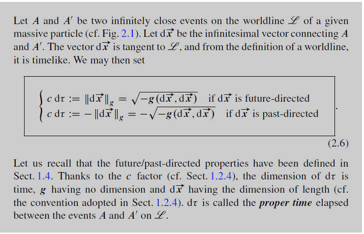

Hello,
There is two notions of time : proper time (invariant relativist) and coordinate times (arbitrary). In special relativity particles are described as points, as in classical mechanics. A “particle at a given instant” (proper time) will be represented by a point in the spacetime E (an event), and the “successive positions” of the particle will draw a one-dimensional curve in the affine space E (worldline of the particle).
Relativity has banished the concept of absolute time. It however introduces along each worldline a privileged time: that given by the metric tensor according to : (2.6).
what kind of "time" is it question ?Patrick

referframe said:
how can that be if QFT is relativistic? In relativity, time and space are much more than just abstract indexes. They form a unified space-time with the Minkowski metric.
He didn't say "time and space", he said "time and space coordinates". The coordinates are parameters; each unique set of 4 coordinates labels a distinct event in spacetime, so spacetime can be thought of as a family of events parameterized by the coordinates. And each event has its own set of quantum field operators in QFT; so the coordinates parameterize the operators just as they parameterize the events.
